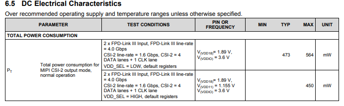

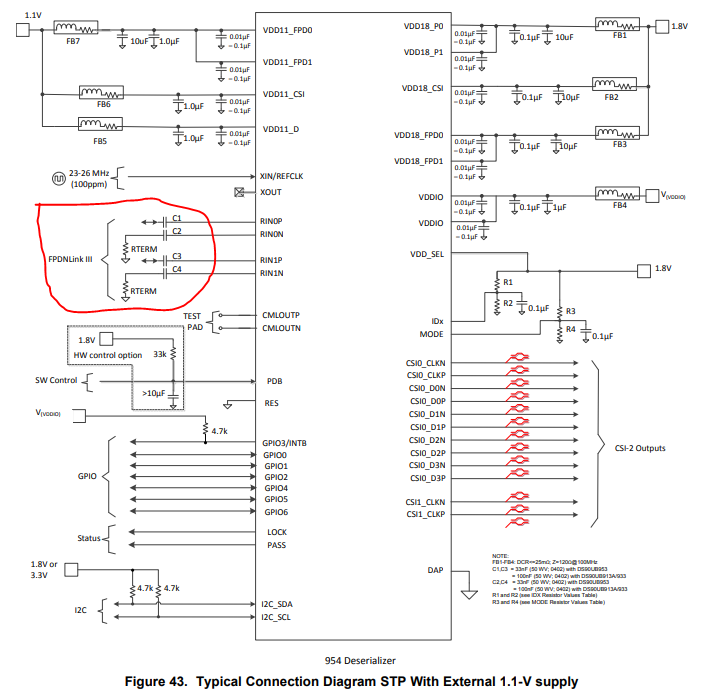

Our customer is evaluating DS90UB953 and DS90UB954 on the STP mode.
We have a question about VDD_SEL setting.
We would like to know difference of Internal 1.1-V LDO mode and External 1.1-V LDO.
I know the power consamption is the one of the difference poins.
Is there other difference poins?
Is there a advantage or a disadvantage due to the difference?
