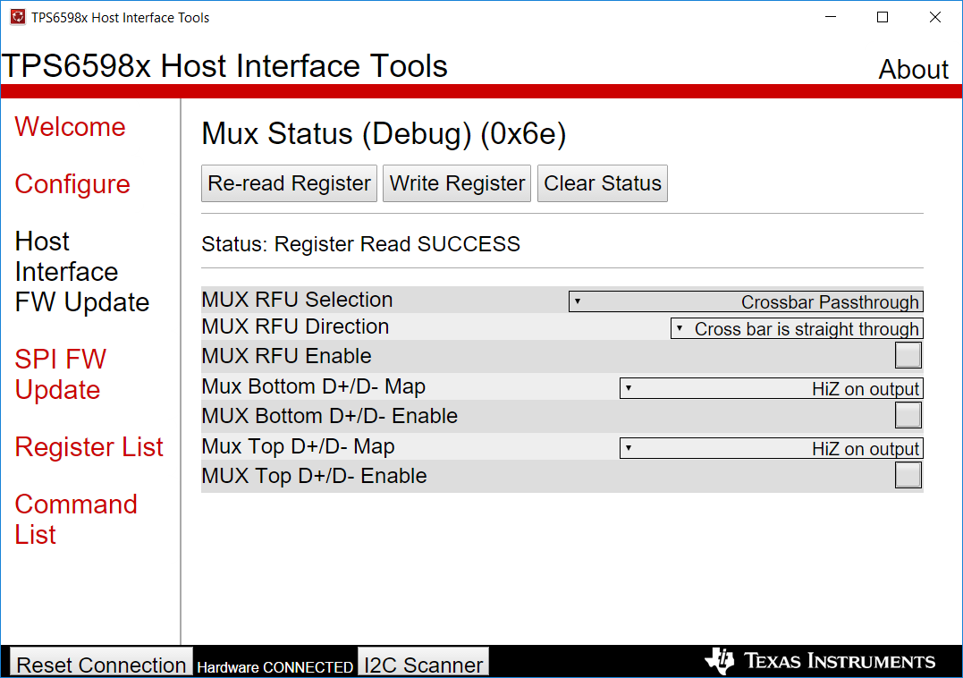

  • Hi Eric,
    The TPS65982 does connect SBU lines to SWD_CLK and SWD_DAT in Debug Accessory mode.
    1. When Debug Accessory is connected, Mux Status register 0x6e indicates that MUX RFU Selection is "SWD_CLK to SBU2, SWD_DAT to SBU1" (see below)
    2. We tested this electrically and the observed behavior matches the register setting, i.e. signals are passed from SBU pins to SWD pins in Debug Accessory mode only.
    3. This is also consistent with your post here: https://e2e.ti.com/support/interface/usb/f/1008/t/609163 which states that "Lastly, the system port signals SWD_CLK and SWD_DIO are routed as analog signals to the USB Type-C port signals SBU1 and SBU2, respectively."
    I tested using latest released versions of config tool  (3.17) and firmware (1.12.07).
    This behavior is important for several reasons:
    • We want to use SWD lines to debug the host controller. In this case we cannot rely on correct operation of host controller to read connection status and program the crossbar
    • Programming the crossbar from the host controller appears to be unsupported by TI. The Mux Status register (0x6e) is undocumented as far as I can tell. (Can you share the register specification for this register?)
    So I would like to return to the original question, is it possible to disable TPS65982 SWD controller so that we can use these pins to debug the host controller in Debug Accessory mode?
    Thanks Eric!
    Martin
    P.S. Here's the Mux Status register with Debug Accessory disconnected:
    And with Debug Accessory connected:
