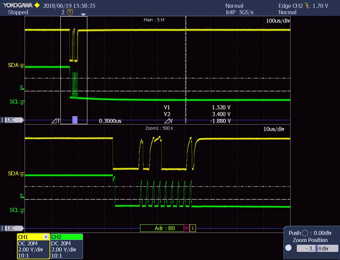

Dear team
We found I2C tr waveform between TI, TCA4311ADGKR and NXP, PCA9511ADP are difference, TI close the Max limit criteria for 400kHz and rise time is non-monotonic compare with NXP part.
Sometime I2C not acknowledge for TI IC.

Could you pls kindly give a reason why TCA4311ADGKR waveform look bad when operate at 400KHz I2C fast mode.

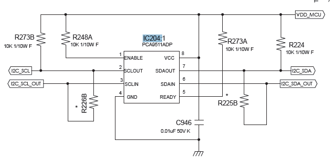

Application circuit is as following, pull up resistor is 10Kohm for both in and out pins
cid:image001.png@01D408B4.10592480
PCA9511ADP
TCA4311ADGKR
