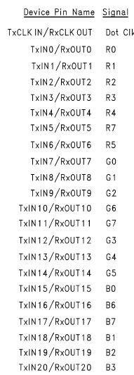

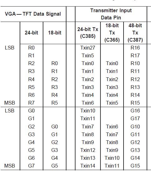

Data mapping in AN-1127 document is different from datasheet.
In the document AN-1127, R0 is mapped to Txin27, but is mapped to Txin0 in the datasheet.
Please Can you check the data Mapping for correct?

Hi I.K.
You will find it in DS90C385A DataSheet 6 Page.(AC Timing Diagrams)
I attached the datasheet of the panel.

Hi Louis,
Below is the mapping you should use for your panel:
Pin Name | Signal |
TxIN0 | R0 |
TxIN1 | R1 |
TxIN2 | R2 |
TxIN3 | R3 |
TxIN4 | R4 |
TxIN6 | R5 |
TxIN27 | R6 |
TxIN5 | R7 |
TxIN7 | G0 |
TxIN8 | G1 |
TxIN9 | G2 |
TxIN12 | G3 |
TxIN13 | G4 |
TxIN14 | G5 |
TxIN10 | G6 |
TxIN11 | G7 |
TxIN15 | B0 |
TxIN18 | B1 |
TxIN19 | B2 |
TxIN20 | B3 |
TxIN21 | B4 |
TxIN22 | B5 |
TxIN17 | B6 |
TxIN23 | B7 |
TxIN26 | DE |
You can leave TxIN24 and TxIN25 floating. Let me know if you have any more questions.
