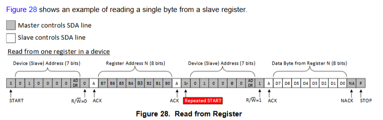

    Our I/O expander actually will NACK if you sent a read bit without doing a write previously. Please refer to this diagram in the datasheet:
    Notice inorder to do a proper read, you must:
    1) send the device address with a write bit
    2) send the address you want to read from (think of this as adjusting a pointer in a software sense)
    3) either initiate a stop condition then a start condition or if you have multiple masters on the bus, initiate a repeat start
    4) send the device address again but this time send a read bit instead
    5) from this point on the IO expander will become the transmitter (on data line, master still needs to send clock pulses)
    6) master should ACK to receive more bytes or NACK to stop receiving bytes
    I believe if you want to verify this device works, you should just send a write bit after the address to receive your ACK.
