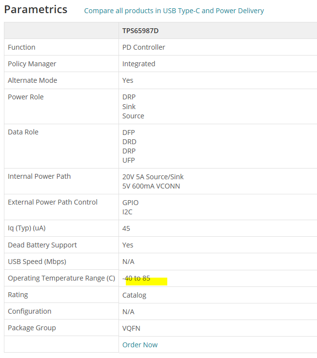

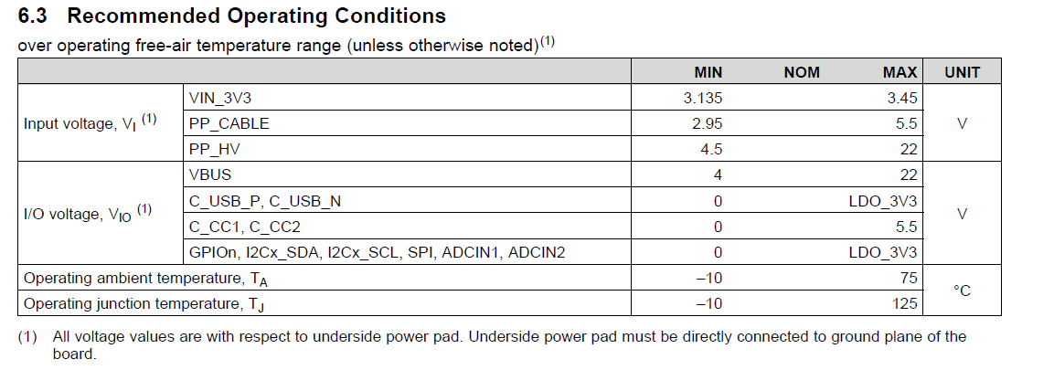

Our Customer want to use TPS65987D to design, but he confuse about Temperature range.
The Parametrics describe Operating is -40~85
Datasheet describe is -10~75
Which one is correct description?
Customer condtion is -30~85, Is this part suitable for this condtions?
