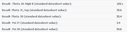

    can you supply a value for the thermal inpedance JUNCTION to CASE, please.
    We use the PW package.

  • Hey Harald,
    I should be able to do that, this will require me to put in a request for a thermal modeling simulation. Depending on how many other requests there are in the queue, this could take up to two weeks (typically get feedback within 3 days though).
    I will update you when I hear back on the results of the thermal request.
    -Bobby
  • Hey Harold,
    I got the thermal results back:
    -Bobby
