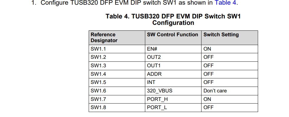

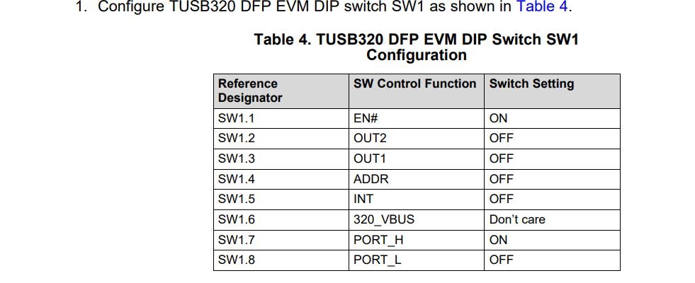

I am using TUSB320EVM for testing purpose.  I am using it in DFP mode by setting the the switch position as follows.

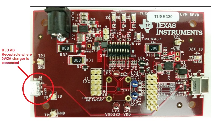

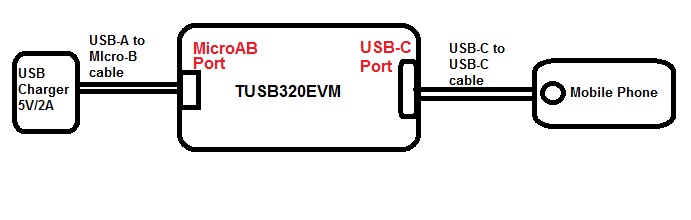

I am connecting a charger adapter of 5V/2A on microAB port J6 via USB-A to Micro-B cable. On the other side on USB port C I am connecting mobile phone via USB type-c to USB type-c cable. As soon as I am connecting the Phone the ID pin goes low and LED D4 glows. Which enables the switch U2.
In my application I want mobile phone to get charged with the voltage on USB-C port. But it is not charging even though I am getting 4.5V on the USB-C VUBS line. Below is the block diagram.

  • No, I am not USING 5V DC jack (J5) on the EVM. I am using Micro AB receptacle (J6) on the EVM to connect 5V/2A charger via USB A to micro USB-B cable. The phone is charging when it is connected to the charger (5V/2A) directly. Phone starts charging with any charger more than 1A rating.

    I am attaching the USB port sanp where I am connecting the charger.

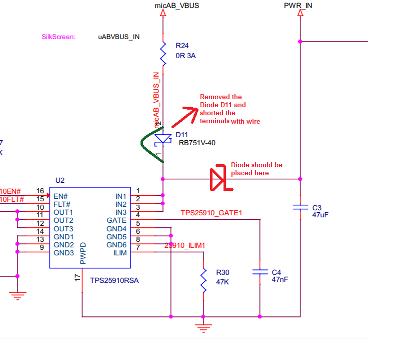

    I have ordered an I2C master to configure I2C registers. It is yet to receive. However a good thing is that I am able to charge all the mobile phones even the iPAD also by doing a small modification in the circuit. I am not sure whether it is mistake in the EVM schematics or it is kept purposefully.
    I removed the diode D11 and shorted the PCB pads with wire. As i can see in the diode datasheet that it is rated to 30mA forward current and it in series path from where the charging current is flowing which is about 1A. The diode should be placed on the other net which is connected to PWR_IN as indicated in the diagram
    However still I am not able to charge the phones with the actual rated current of the charger. For e.g. if I am connecting 1A charger the phone is taking 0.96A to 1A if I am connecting a higher rated charger like 2A or 4A it is still taking close to 1A only. I think this is something related to the I2C register configuration for current advertisement. Once if I get the I2C master to program it, I will have more clarification.
    Please let me know your thoughts on the schematics change and issue in the charging current value.

  • That might be an incorrect diode on the EVM, but where you placed it it should not effect the performance in your application because you are using the micro AB port to power the EVM.
