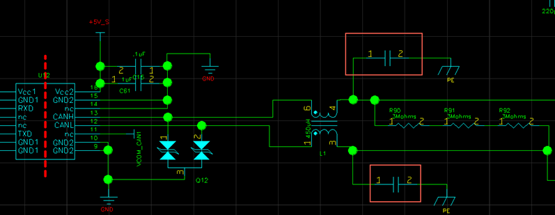

My customer is using ISO1050 in their design. They want to know how to choose the capacitor in red box. Do you have any guideline for this?

Ceramic is fine. I don't think we have any material on how to choose that capacitor. Capacitors are used for this function in the ISO1042DWEVM. You can see that we chose 68pF for that EVM (see page 4).
