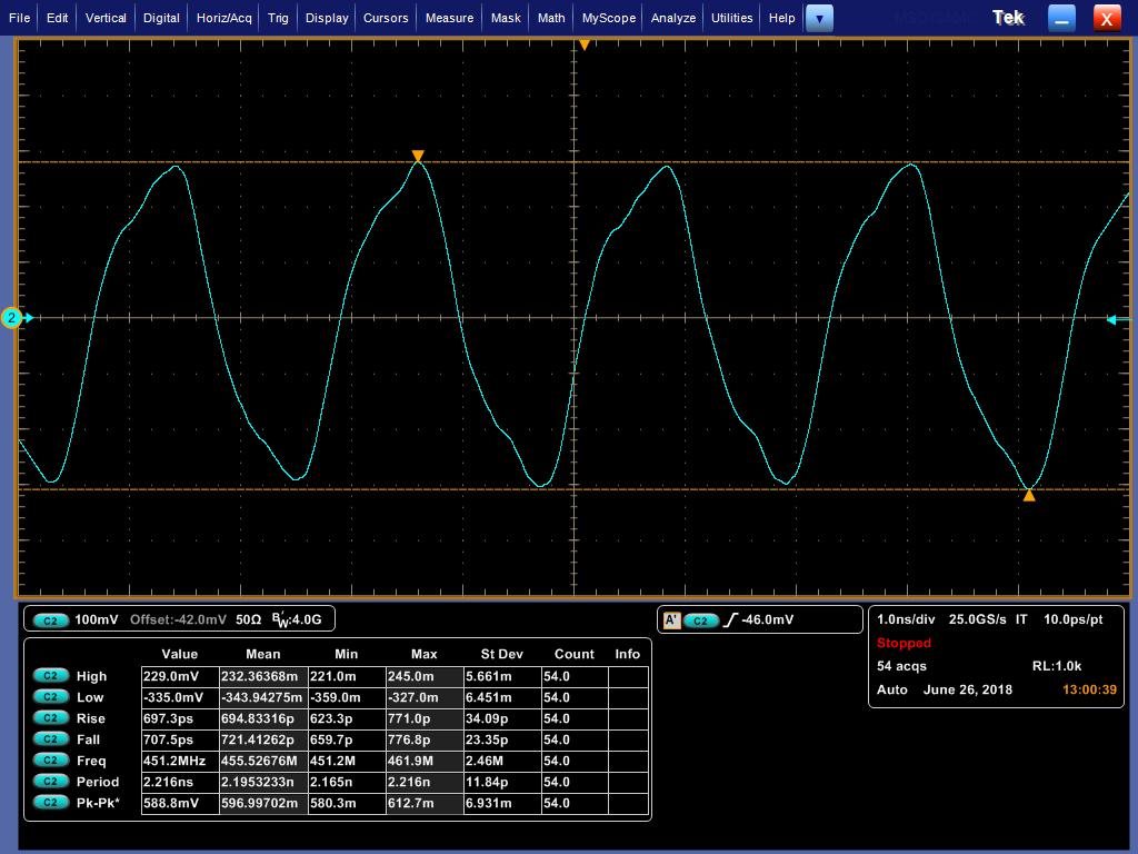

    2. Can you share a screenshot of the DSI_CLK? Since you're getting a PLL_UNLOCK error it's possible the DSI side has signal integrity issues.

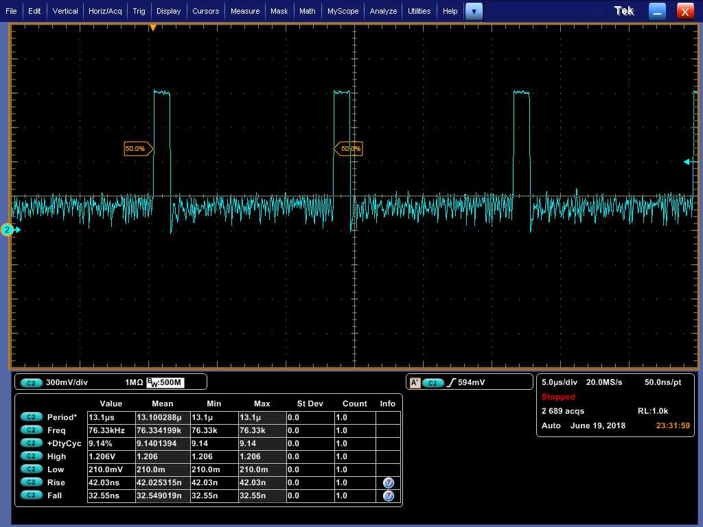

    4. Can you check the line time on the DSI side? The line time (horizontal sync to the next horizontal sync timing from the APU) on the input is preserved when outputting onto the LVDS interface. If the line time is different from what is calculated by the tool, this will cause issues. Even if the DSI source is outputting streams in a burst manner, it is important for the DSI source to fill in the rest of the line time with blanking packets (or LP11) to meet the line time requirement. The line time should be 13.092us.

    2. Please see the attached image fro DSI clock.

    4. Please see the attached DSI waveform of DSI data for line time.
    Thanks.

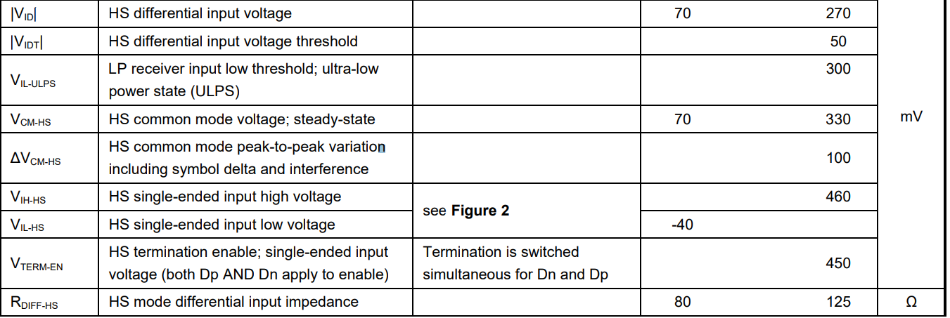

  • Hi Maumita,
    Since you are still getting the PLL_UNLOCK error it leads me to believe that there are signal integrity issues with the DSI_CLK.
    Can you double-check that it's within specification of what's listed in the datasheet? For example, from the screenshot you provided it looks like the differential voltage is out of spec.
