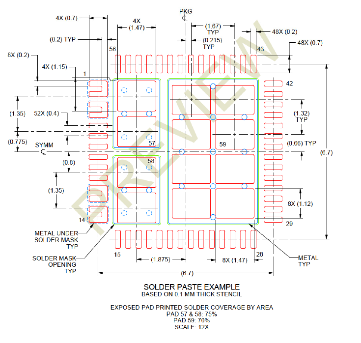

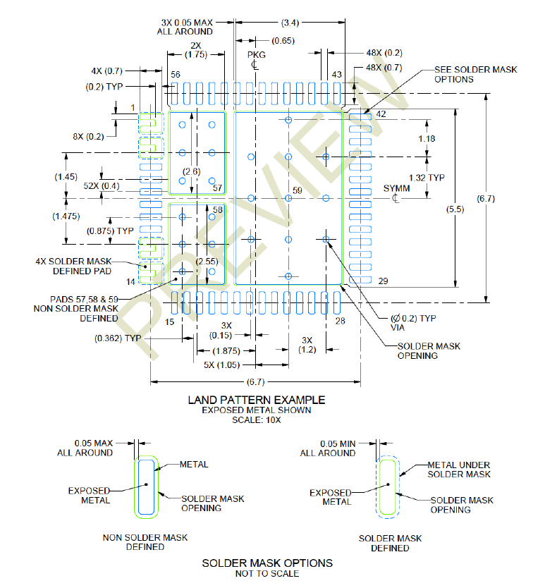

The datasheet of TPS65987D have only following information about package size.
1. 7-mm × 7-mm
2. 0.4-mm pitch
3. 56 pin
Could you give me more detail package size information for layout?

Hello Nakano,
Thank you for posting this question. The TPS65987D is a new part, and is still in early release. This information seems to have been excluded from the datasheet that was uploaded online. Here are the diagrams that I think will help you
Let me know if this helps you or not! If so, please click This resolved my issue
