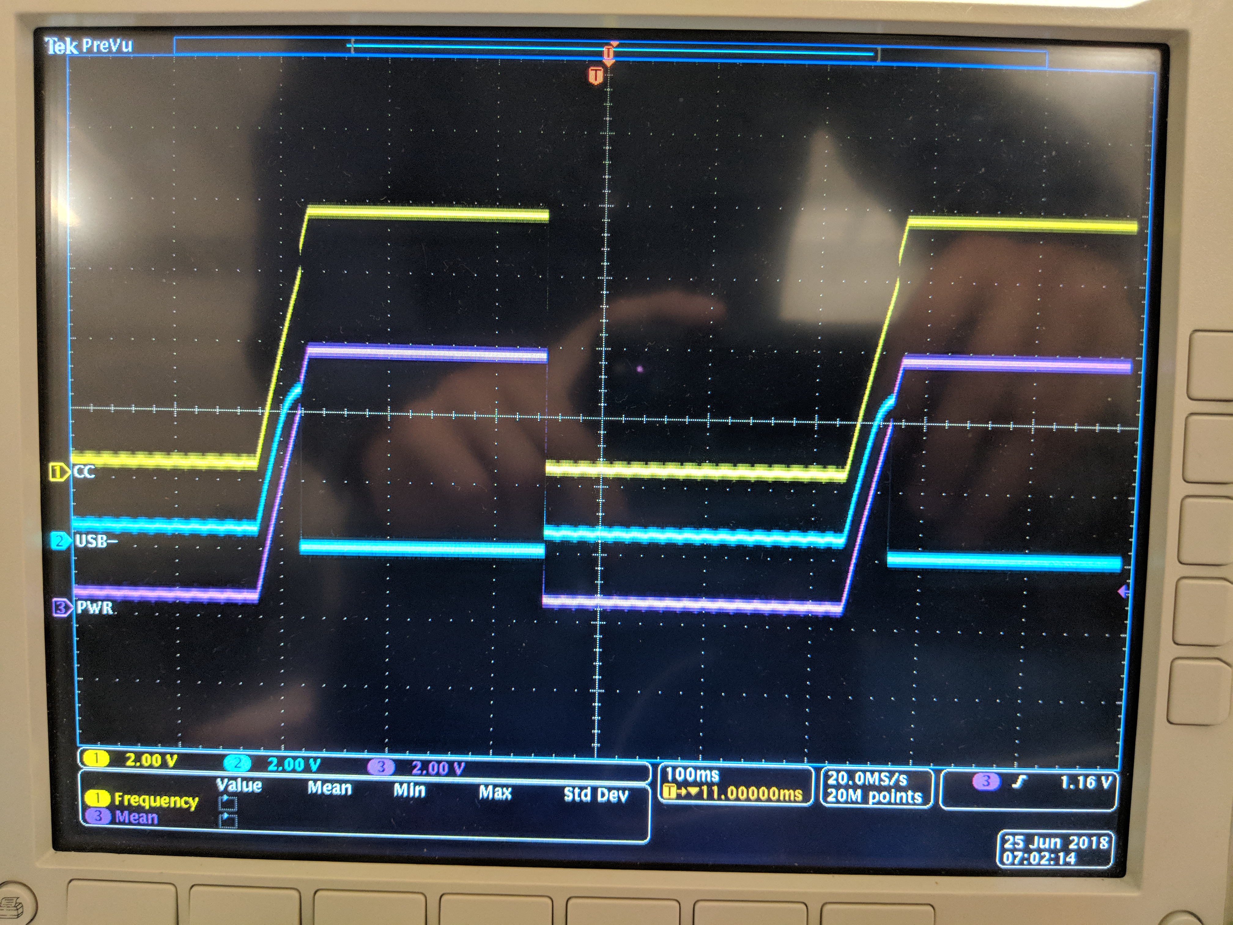

TPD2S300: CC Protection appears to take too long
Part Number: TPD2S300
While evaluating the TPD2S300EVM and see some odd behavior that does not appear to agree with the datasheet. The cc protection does not seem to cutoff in the 100ns mentioned in the datasheet. It seems to take 20ms.
We are testing by shorting both c_cc1 and c_cc2 to vbus.
