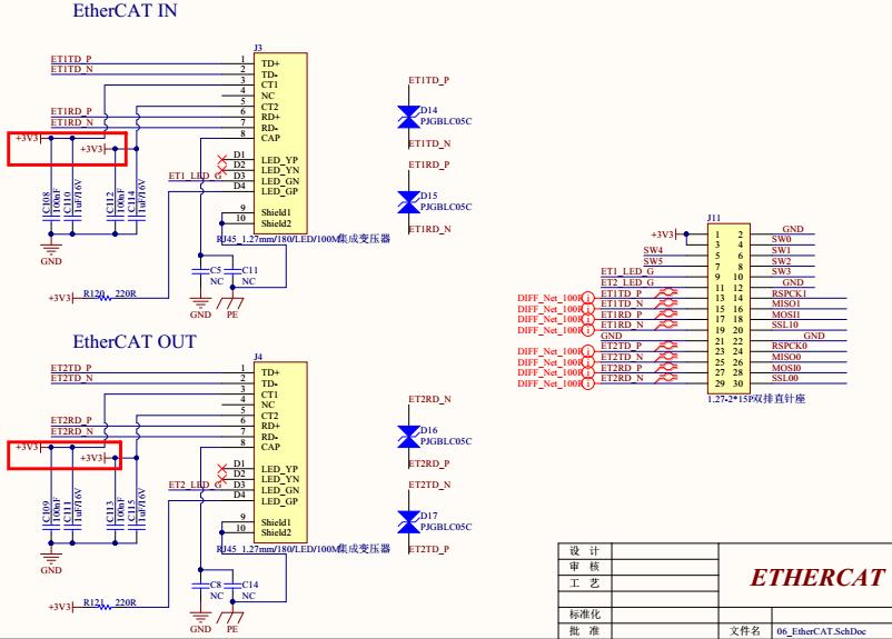

         We used 2pcs TLK106L in the application of EtherCAT communication.The electrical function is OK but there is a issue when ESD test on RJ-45 Cable.
The ESD contacting voltage is 4KV and the ESD test can make the EtherCAT communication break off until the MCU reset the PHY(TLK106L).After ESD test,none of the components are broken.
The fail symptoms are on every PCB(both of 2pcs TLK106L on the same PCB).
Our schematic and PCB layout is designed according to TLK106L datasheet,the network transformer and TVS between TD+/RD+ and TD-/RD- is designed close to RJ-45 Cable.
The ESD rating of TLK106L is +/-16kV on Ethernet network pins (TD+TD-,RD+,RD-) and is too higher than the test voltage(4KV).So what is the probable reason for this issue?
Which signal should be measured by oscilloscope to help the failure analysis?
Our Schematic is below:

  • Dear Aniruddha
           There are two syptoms when ESD(4kV) test on EtherCAT IN ports.
    The one syptom is that the link break off between the testing slave device and the next slave device connecting OUT ports,we read the registers of the two PHY and we found the data on PHY_IN registers(0~31) was normal but the data was 0xFFFF on PHY_OUT register(0~31).
    The other syptom is that the link break off on both the testing slave device and the next slave device,we read the registers of the two PHY and we found all the data was 0xFFFF on PHY_IN&PHY_OUT registers(0~31).
    When the PHY stops communication, the MCU can not write the any registers of PHY,
    So what is the next step to analyse this issue?

  • Hello Aniruddha
       Thanks your suggestion at first.We tried to separate the signal GND from PE(product housing GND) as shown below,but it still fail in ESD test.Our test conditon is less harsh than IEC61000-4-2,the ESD contacting voltage is only 4KV and the contacting position is TD+,TD-,RD+,RD- pins of RJ45 Connector.
    In addition,we want to know the difference between DP83822 and TLK106L except ESD rank.If we use DP83822 to replace TLK106L,do we need to modify the register setting?we worry about the registers are different because the EtherCAT software  outsource the third party solution company and it can not be modified complicatedly.
