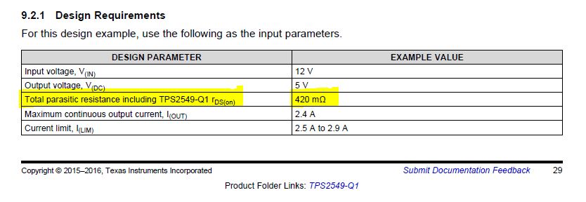

  • Hi Adam,
    thanks for your clearly reply~

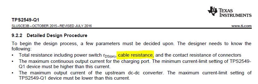

    One last question about CS pin want to confirm with you.
    1a. According to 9.2.1 ~ 9.2.2, can I just following the example rds(on) = 420m ohm to design in ?
          Cause our product is the docking station and doesn't include the cable
    1b. If I don't want this features (CS), does it need to pull down or just let this pin empty?

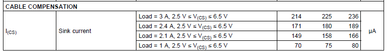

  • Hello Jimmy,
    I would say to tie the CS pin to a 5V source based on this graph. However, it would also make sense to not have it connected sense you will not be applying a load to the pin. I have not seen the TPS2549 used without implementing the cable compensation feature, so I am unsure how it will operate without having that connection.
    What I would recommend doing is having resistor tied to 5V and resistors tied to GND, so that if one does not work, you can depopulate/populate the resistors to change the design.
    Let me know if this helps answer your question.
