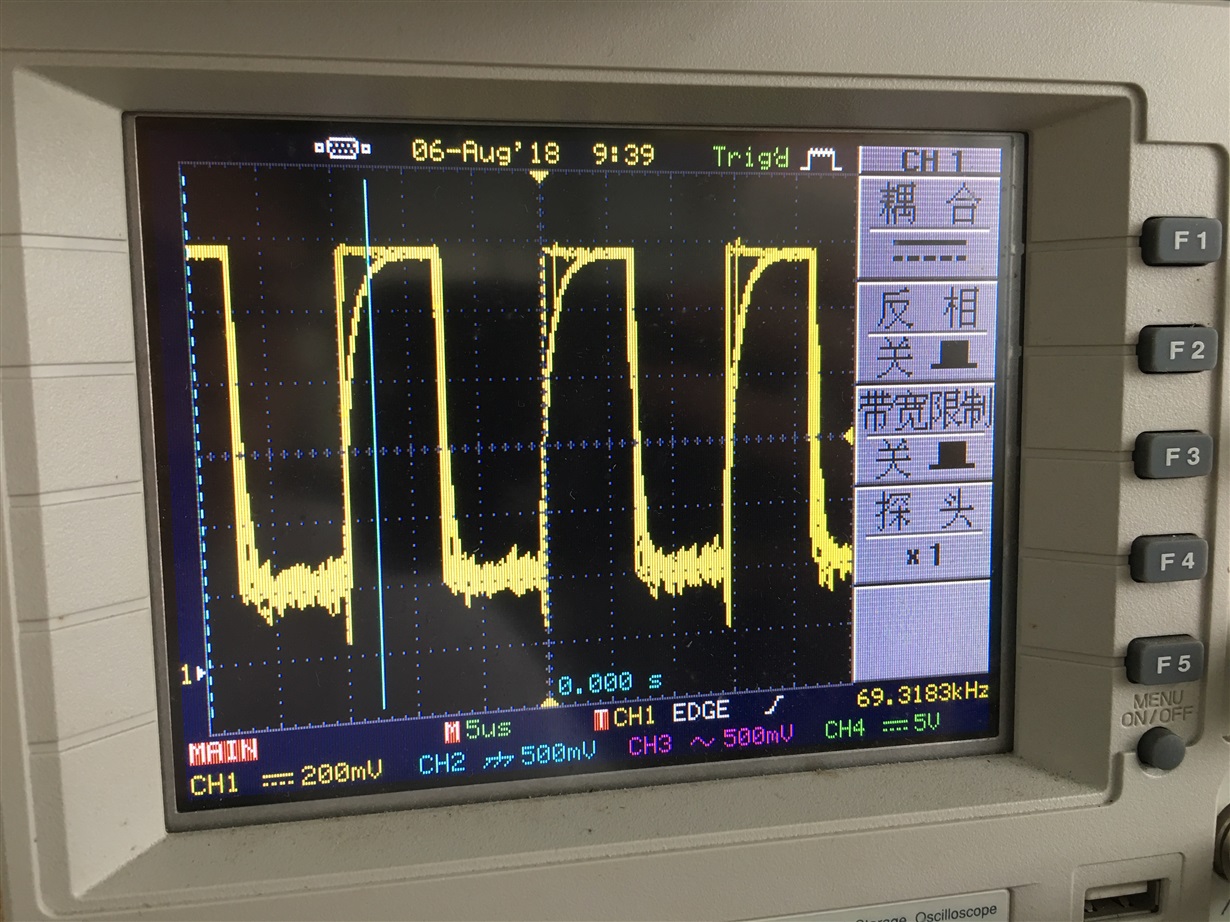

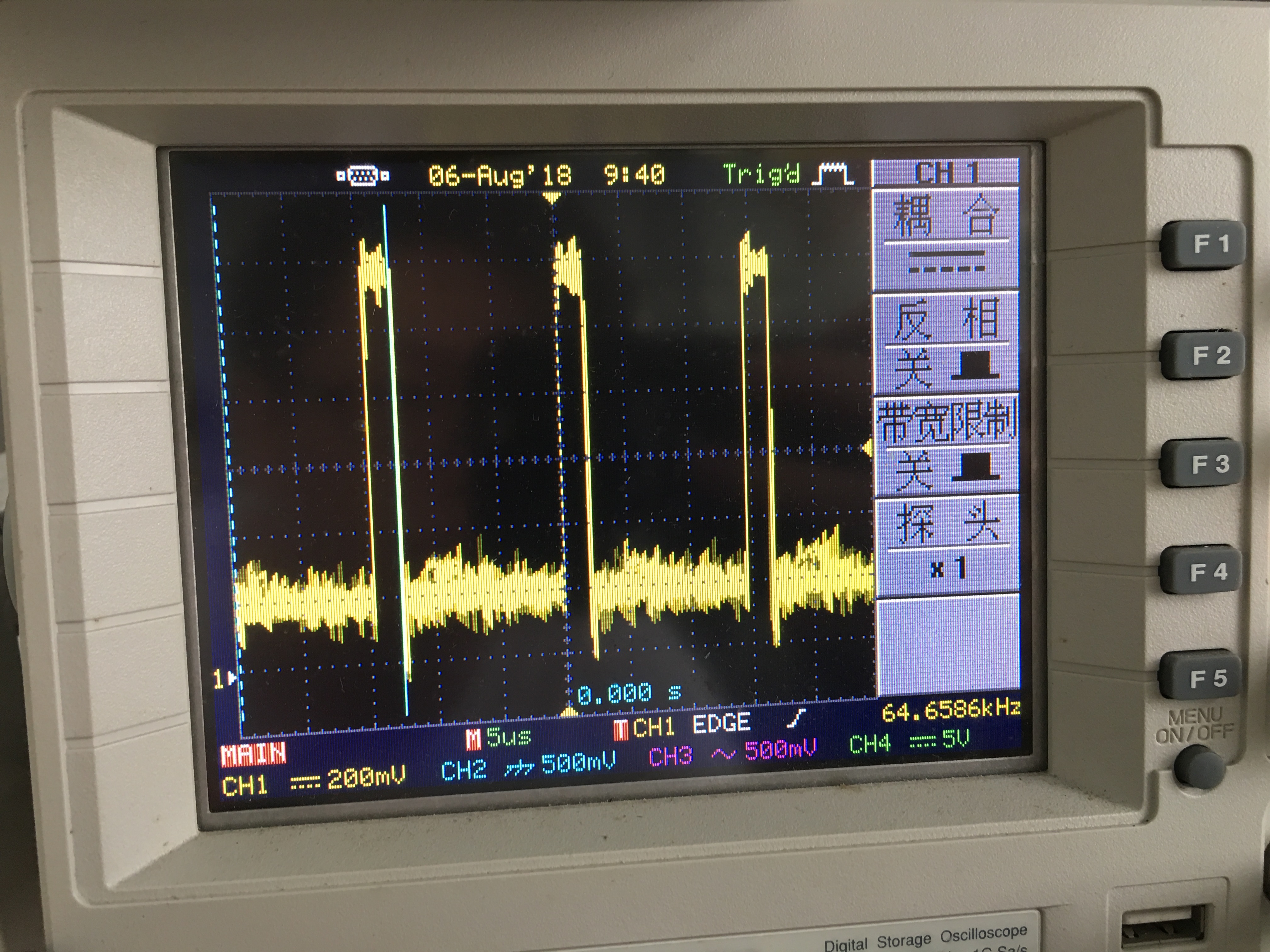

    data lane signal from sensor:
    data lane signal from UB954:
  • the csi2 output is dependent on the video format, not relied on sensor or internal pattern gen. basically the output is correct. I don't see any issues here.

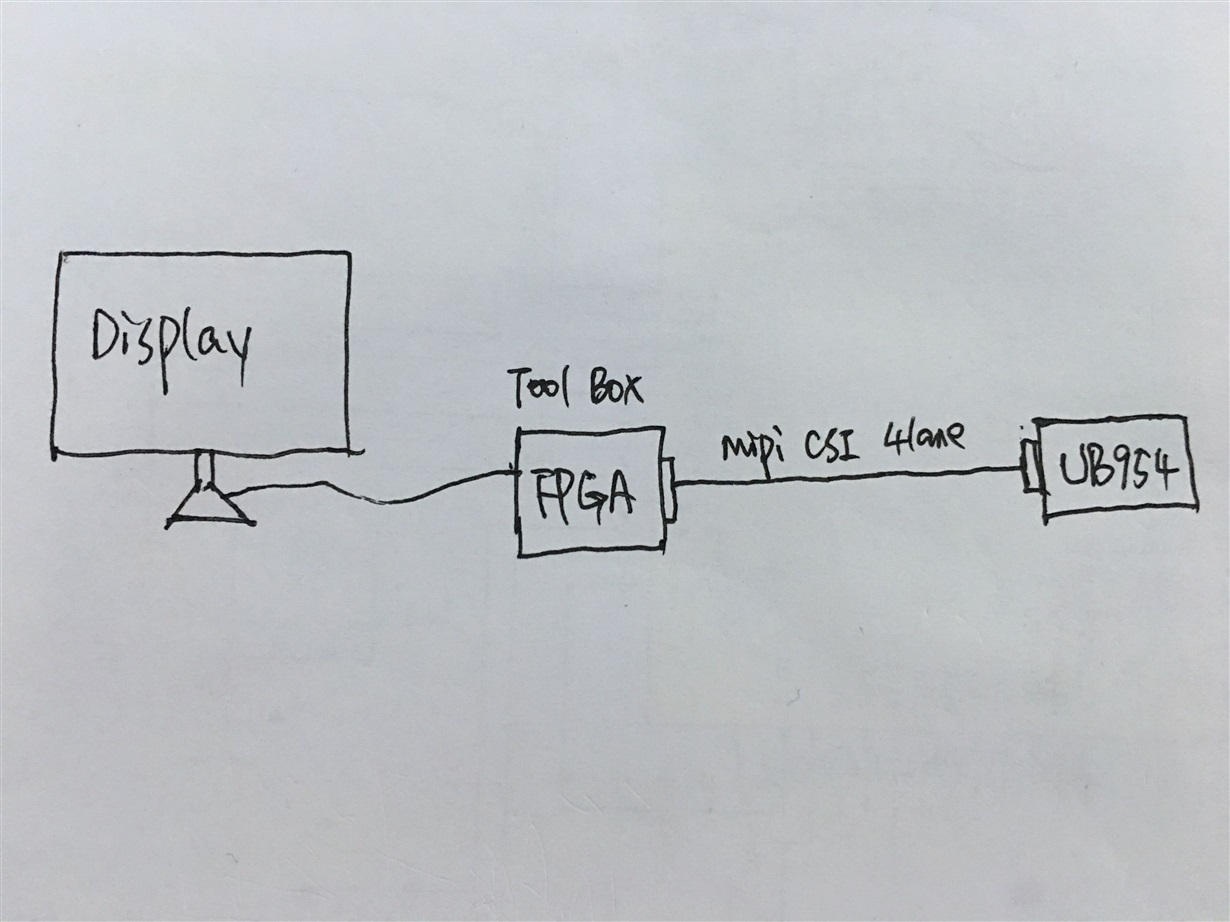

  • The block diagram is as below. I want to display the color bar (yuv422 1280*960) generated from 954.

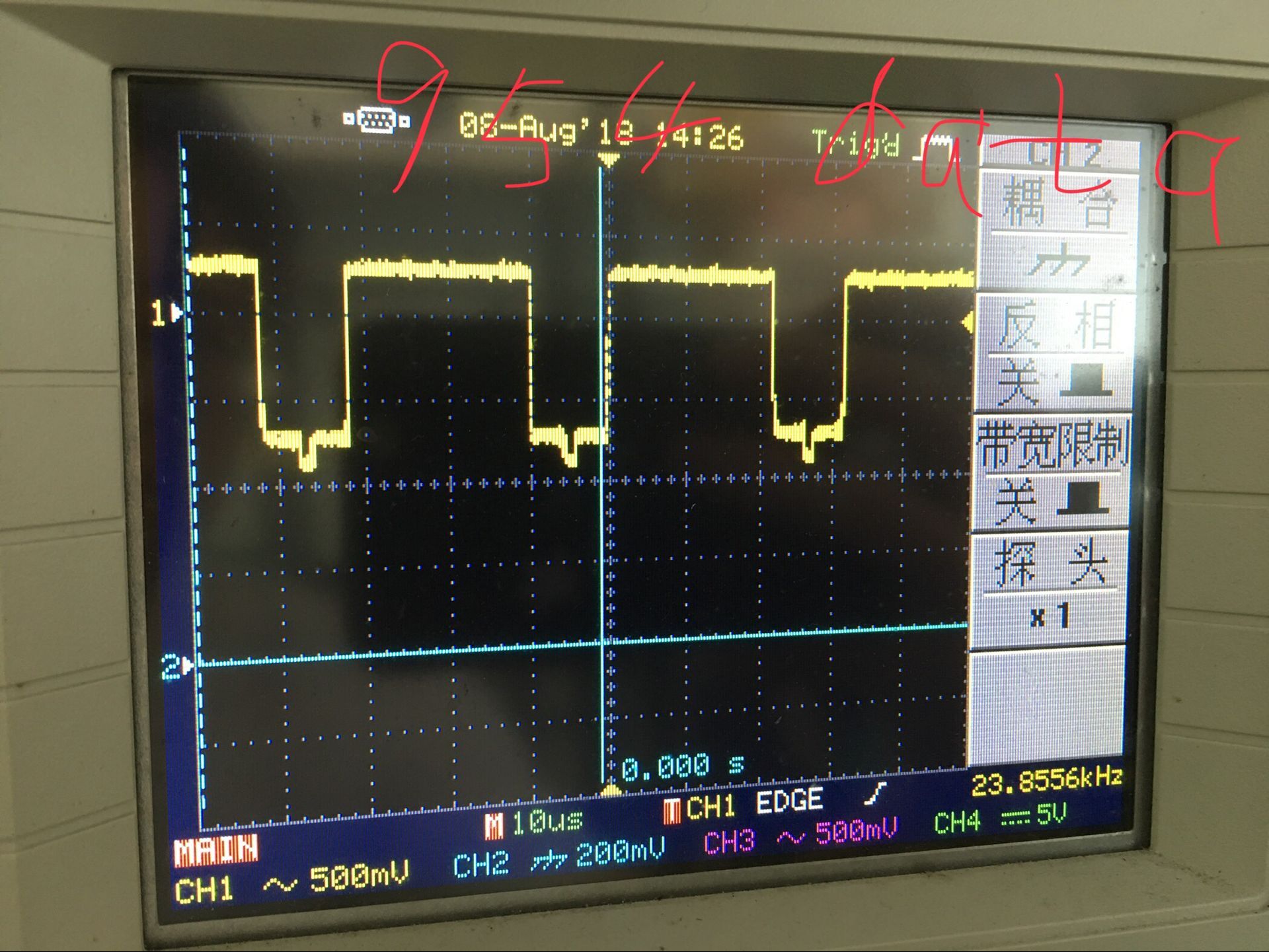

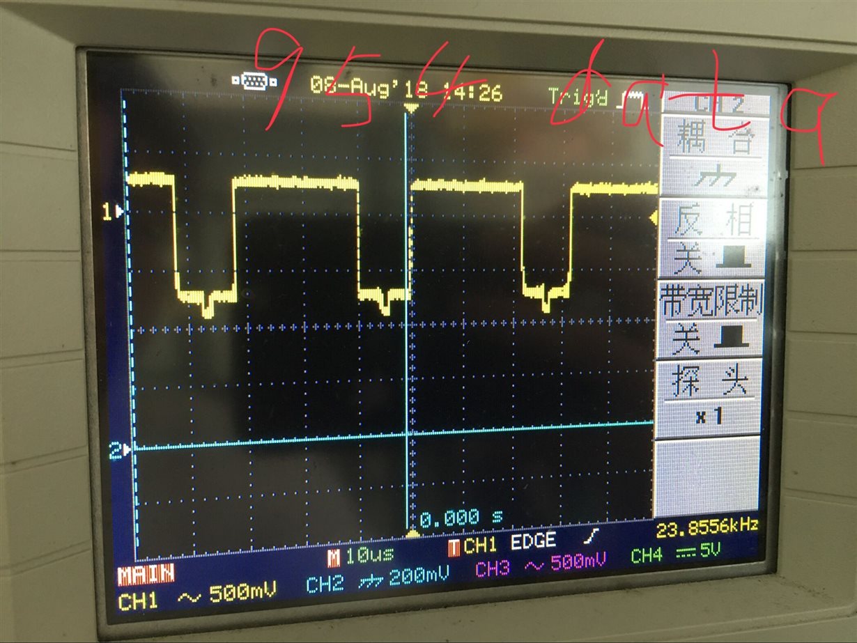

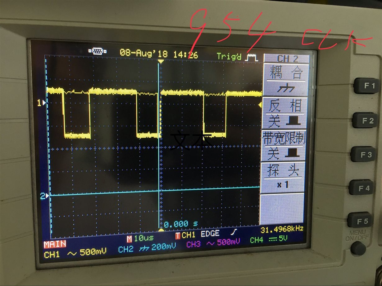

    The clk signal and data signal from 954 CSI TX is as below:
    Is the signal correct? Why the volt is negative?
  • 1. it could test issue, please make sure that your scope is set correctly. it sounds the ch1 is set as AC coupling also bandwidth is not good enough. please refer to TI's test plot in d/s.
    2. please refer to UB954 d/s on the CSI2 forwarding, or you can refer to TI's pattern gen. script in the installed ALP file (last version).
    best regards,
    Steven
