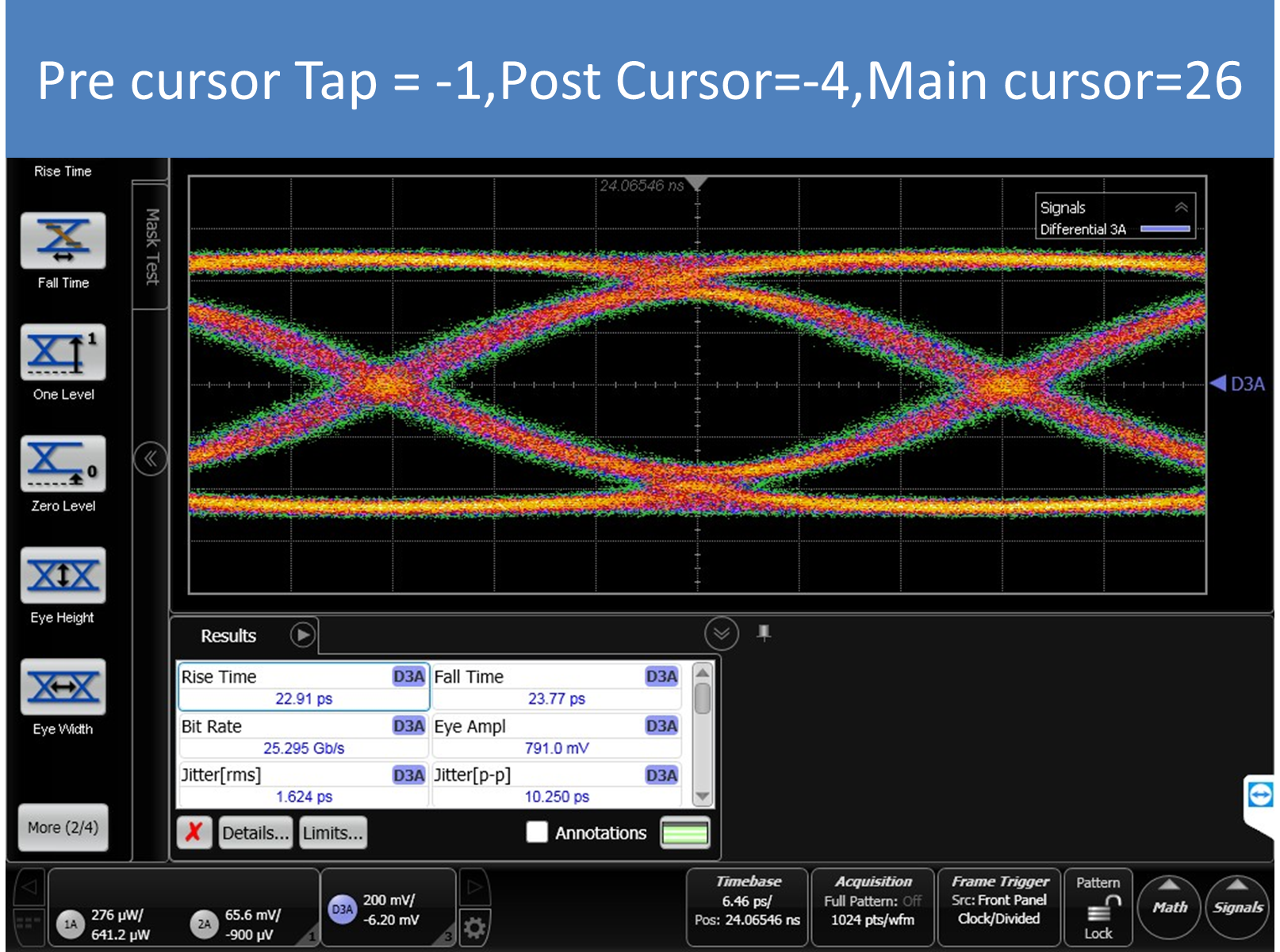

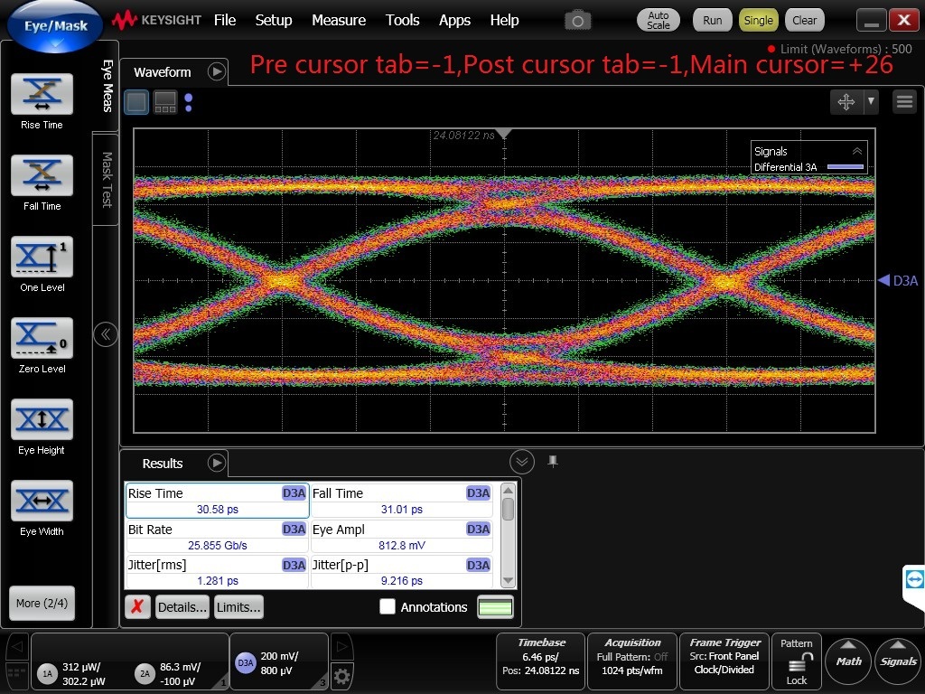

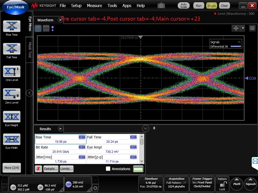

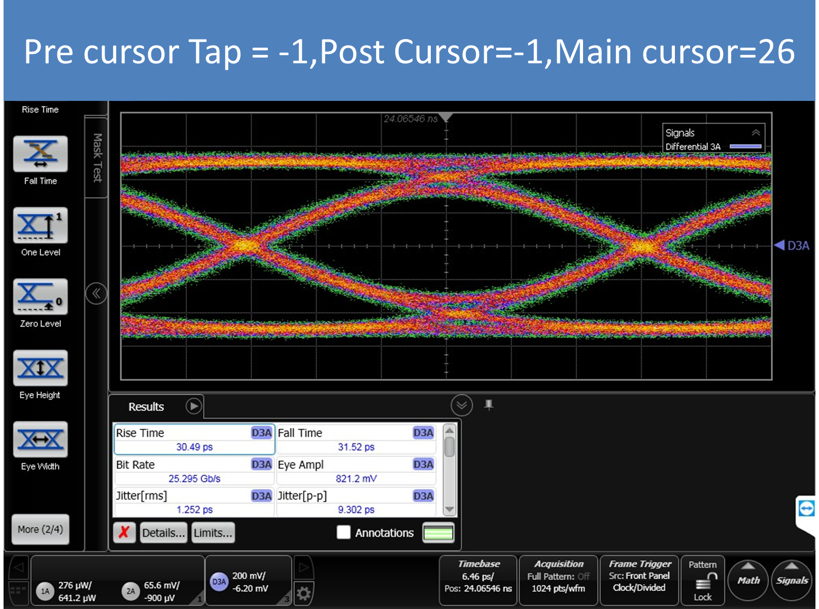

I used DS250DF410 as retimer,Input a PRBS31,25.78Gbps signal to RX0,and get a output in TX0,but the eye diagram output of TX0 is undershoot,when I set  post and pre cursor ,the undershoot is missed,but the
jitter is increase.  I want to get a low jitter and no undershoot out,what should I do? There is the two eye disgram.

    1). Are you saying the 2nd waveform - precursor = -4 - has undershoot and jitter is high? The purpose of the pre-cursor is to emphasize high frequency and de-emphasize low frequency content. So you would see this undershoot if you make this measurement right at the output of the device. It would be a good idea if you can make this measurement at the end of your transmission media with pre-cursor = -1 and then compare with another waveform where you set pre-cursor to -4. These measurements will help to optimize pre and post cursor settings.

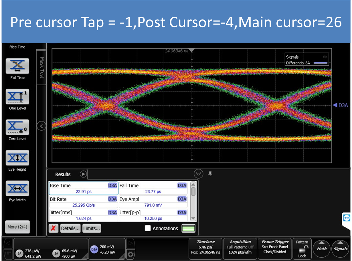

  • Hi nasser

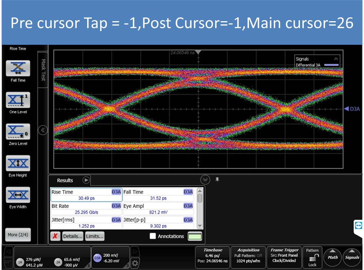

    thanks for you answer.I follow your step.There is the test data bellow.
    when I set Pre Cursor Tap=-1,Post Cursor  Tap=-1,Main Cursor=26,I get a Lower Jitter-RMS and undershoot eye diagram.
    when I set Pre Cursor Tap=-1,Post Cursor  Tap=-4,Main Cursor=26,I get a Lager  Jitter-RMS and lower undershoot eye diagram.

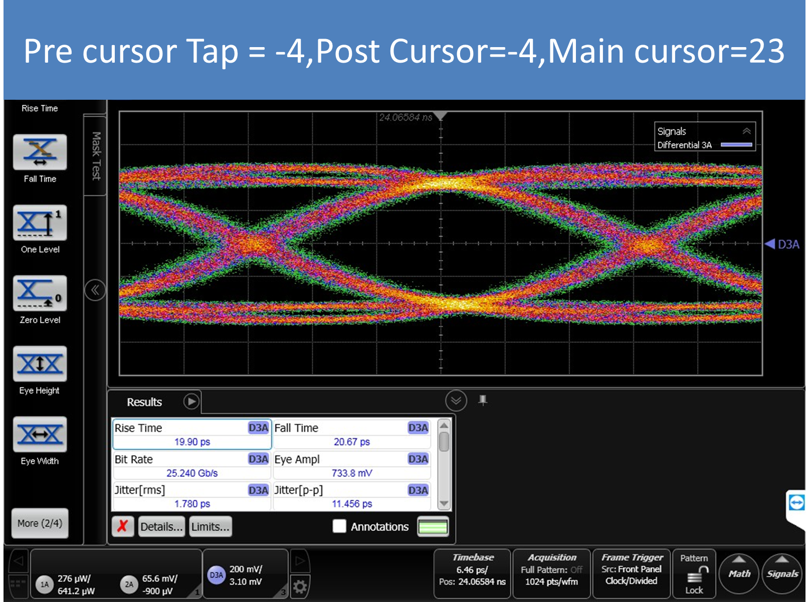

    when I set Pre Cursor Tap=-4,Post Cursor  Tap=-4,Main Cursor=23,I get a Lagest Jitter-RMS and no undershoot eye diagram.
    I would like to get a Lowest Jitter and no undershoot eye diagram,what should I do?  Thank you!

  • Hi Lee
    I tried many group of different pre cursor,post cursor,main cursor and I could not fine the group that get lowest jitter and slight undershoot.
    pre cursor from -8~+8,post cursor from -8~+8,main cursor from -26~+26.But I still not find the group.

  • Hi Kailin,
    These eye openings are still quite large in amplitude.  In some cases lowering the Main cursor amplitude can produce the same low jitter waveform with less overall "undershoot" as you describe.  In most cases I would recommend to utilize the solution with a little undershoot and low jitter as most receivers will benefit from this combination.

  • Hi Lee
    I tried reduce the amplitude,the undershoot is missing,but the jitter is increase.such as,I set the main cursor is +26,the pre cursor is -1,post cursor is -1,I get a 1.291ps jitter-RMS,when I set main cursor +12,the pre cursor is -1,post cursor is -1,I get a 1.535ps Jitter-RMS.
