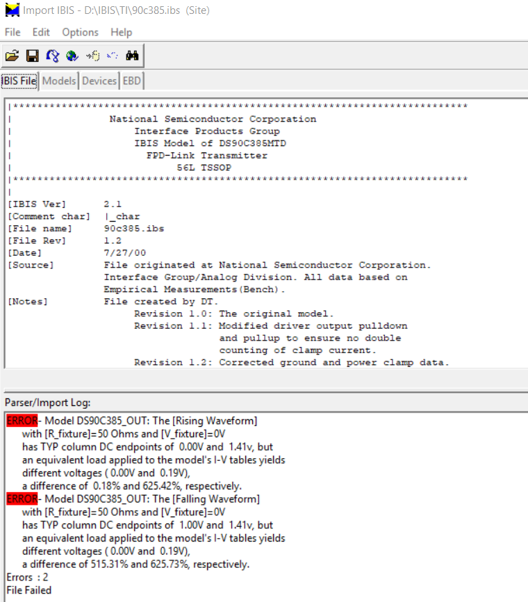

I downloaded the ibs file 90c385.ibs to do some SI simulation on a new design.
My SI tools flag 2 errors with the I-V tables when i try to import it into the tool. (see below)
Is there a fix for this??

Sorry for the delay. This model is around 18 years old so there's little to no support for it. However, the feedback I received from the team is that the waveforms causing the trouble are not required per IBIS standard, so they excluded them in the attached file. It may work or it may bring up more issues with the model, but please try it and let me know the results:
