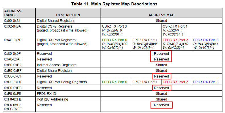

    this picture from spec SNLS500 –JULY 2016 DS90UB964-Q1.
    could i ask a question about there reserved register, what reserved mean, it is private or not used?
    thanks.
    there are alias address in 964 for remote device accessing.
    however, if i am trying to communicate with the 913A, how to assign a remote device address via 913?
    Most of the reserved registers are not used. Some of them are private.
    I did not understand your question!! can you clarify?
    If you connect to the I2C bus of the 913A, can you communicate with it or not?
