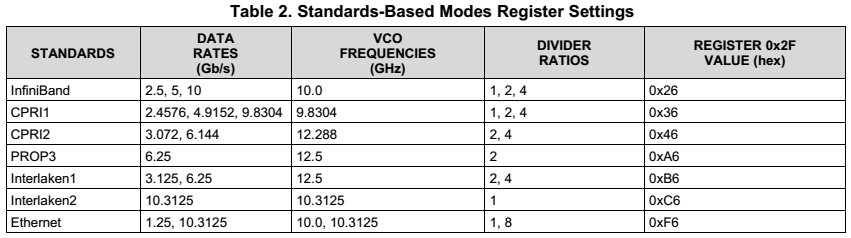

My communication customer want to use DS125DF410 in their BBU product. They want to use it to transfer about 11Gbps data which is complied with JESD204B. They find a table in datasheet page 14 that it just show some specific data rates.
Can DS125DF410 support 11Gbps data rate? How to configure it?
