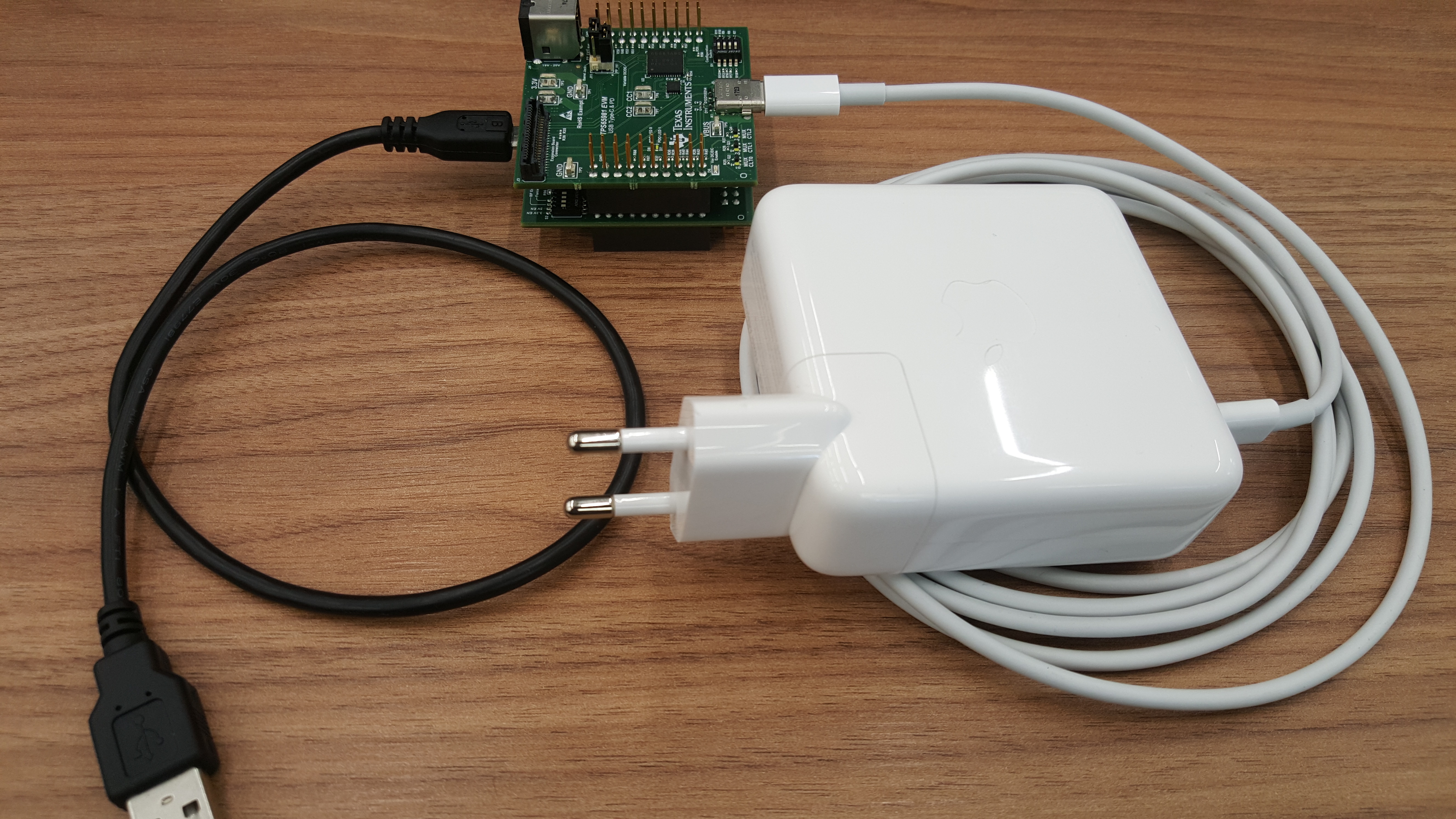

I'm facing an issue with setting TPS65981 to use 20V from source.
My board (TPS65981-EVM) is presenting a strange behavior and I want to know if that's normal (reset and don't set config). For that, I recorded a video:
How can I select my board to use 20V from source?

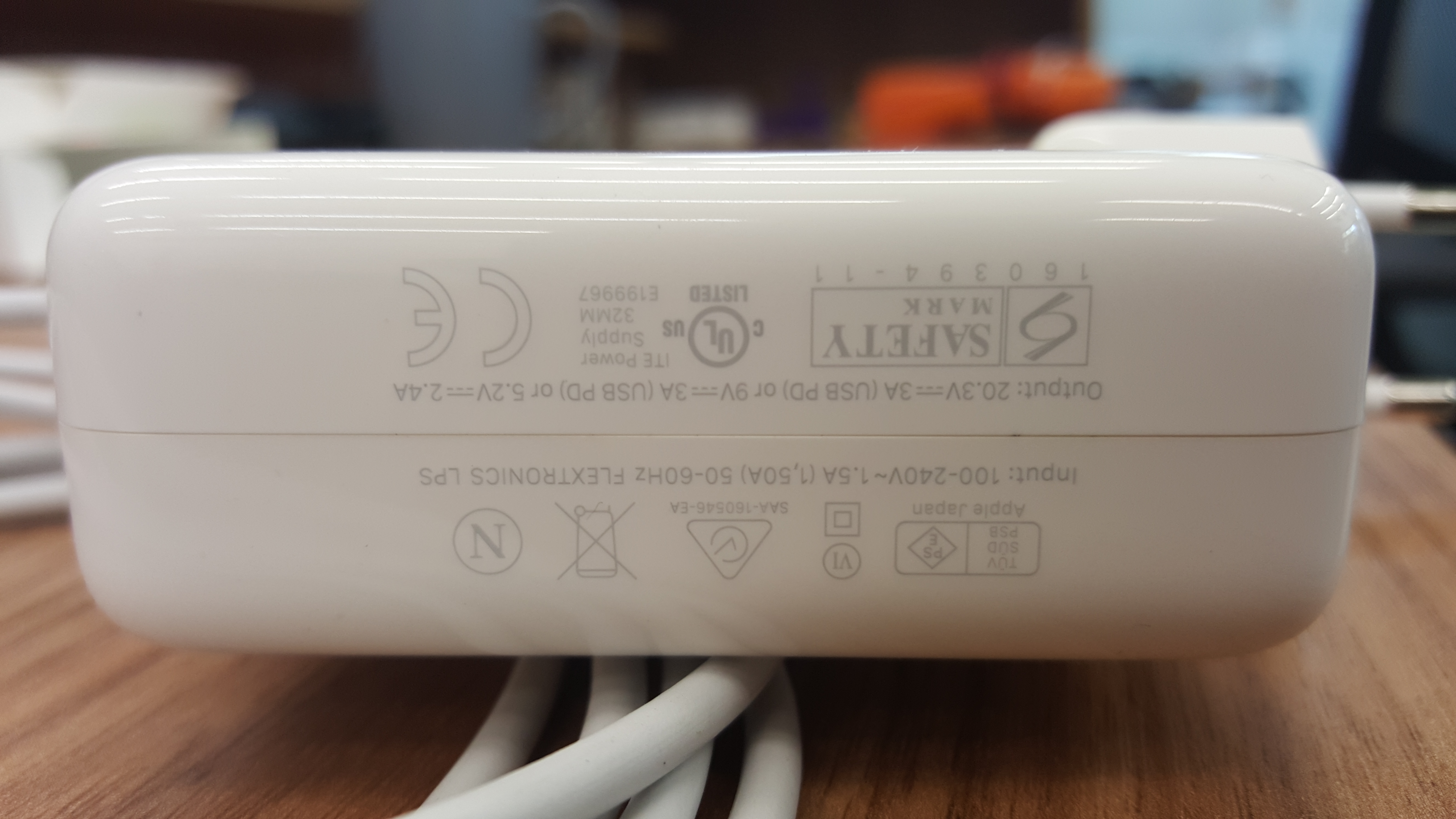

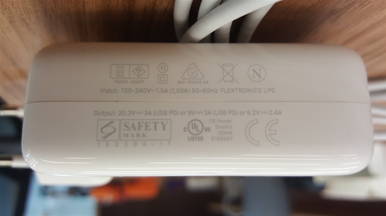

The source I'm using and the setup are above:
Thanks!
  • Finally I got this!
    The problem that was making TPS65981 not accepting any configurations was the Polling mode on the Application Customization Software. I just changed it to Manual.
    And to make the board to use 20V from the source was a little more complicated:
    - First, go to Configuration Registers tab and select Control Configuration (0x29);
    - Read it and PDO Intrusive Mode box must be checked (if it's not, select and write register);
    - Now, go to Debug Registers tab and select Received Source Capabilities (0x30);
    - See what possible Source PDOs is available and remember that (in my case, 1st: 5V, 2nd: 9V and 3rd: 20V);
    - Finally, go to Commands tab and select Send Request Data Object (SRDO);
    - In Object Position just write the number of source PDO you want to use (3 selects 20V) and Execute SRDO;
    - If you received SUCCESS_CMD as Output, the change was successful, if not, check if you are in sink mode.
    - To see if that's for real, go to Debug Registers tab -> Active Contract PDO (0x34) and confirm that the Voltage is 20V.
    That's all ... this module is too much complex :O ... and what is the meaning of sending a SRDO message? Using an external processor, what I have to do to send this message? (datasheet is so much complex but still poor :( )
