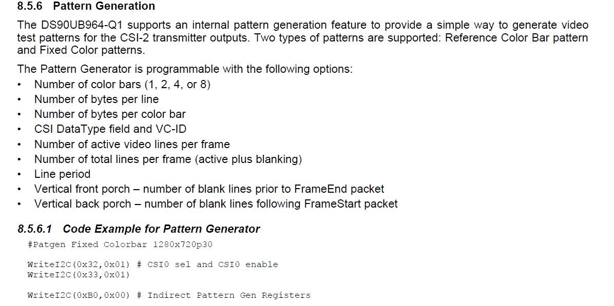

Dears:

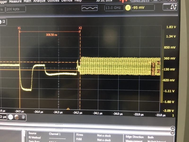

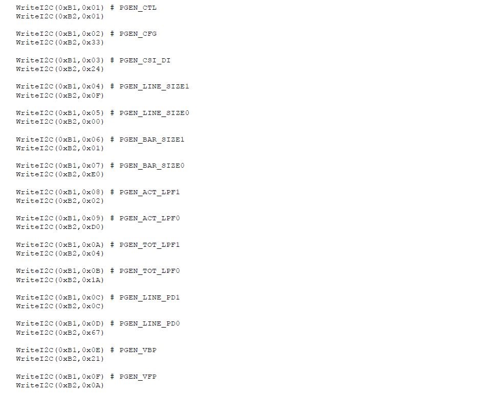

The version of the chip is DS90UB964-Q1 A1, and refer the snls500's Code Example for Pattern Generator it will happen the error of LP transition error from CSIPHY.(Qualcomm 820A)
Is it concerned with CSI_CTL's Regs?Since using the different Regs, the error happens again.
Why dose it happen the error of LP transition error?
