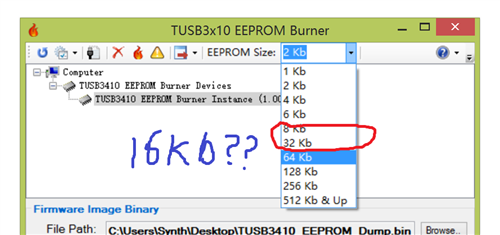

EEPROM Dump File Size Bug and 16 Kb EEPROM Not Supported
Part Number: TUSB3410
1 The EEPROM .bin file size dumped by TUSB3410 EEPROM Burner is incorrect. For instance, the .bin file size is 2000 bytes instead of 2048 bytes when you choose 2Kb.
2 No support for 16Kb EEPROM.
**** My TUSB3410 EEPROM Burner is newly downloaded from TI, ver 2.2.0.0, however it lacks some function from TI employee version.  I wonder how to get a newer one. ****

    Is the EEPROM size kilo-bits or kilo-bytes? Lowercase 'b' usually indicates bits so that seems wrong if it should be bytes. ("KB" instead of "Kb").
    The SW currently defines kilo as 1000 so if you select 2Kb, you get 2000. All the sizes are defined this way in the code. I think it should be 1024 if we are talking about kilo in binary terms (kibibyte).
    I will add 16KB support for the next release.
