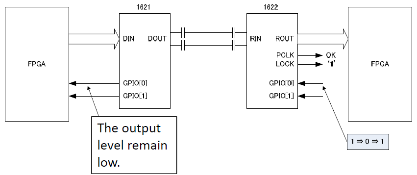

Hi all,
In the case without using I2C,
even if "1" is set to GPIO (0) of DS92LX1622  "1" is not output to GPIO (0) of DS90LX1621.
The LOCK output of the DS92LX1622 is high, so the link may be established.
Looking at the initial value of the registers, the GPIO (0) of the DS92LX1621 is set to output, and the GPIO (0) of the DS92LX1622 is set to input.
So I think that it will operate in the initial state if LINK is established.
Please tell me how to solve GPIO not working.
How should I process each M/S pin and I2C pins when I do not use I2C I/F?
