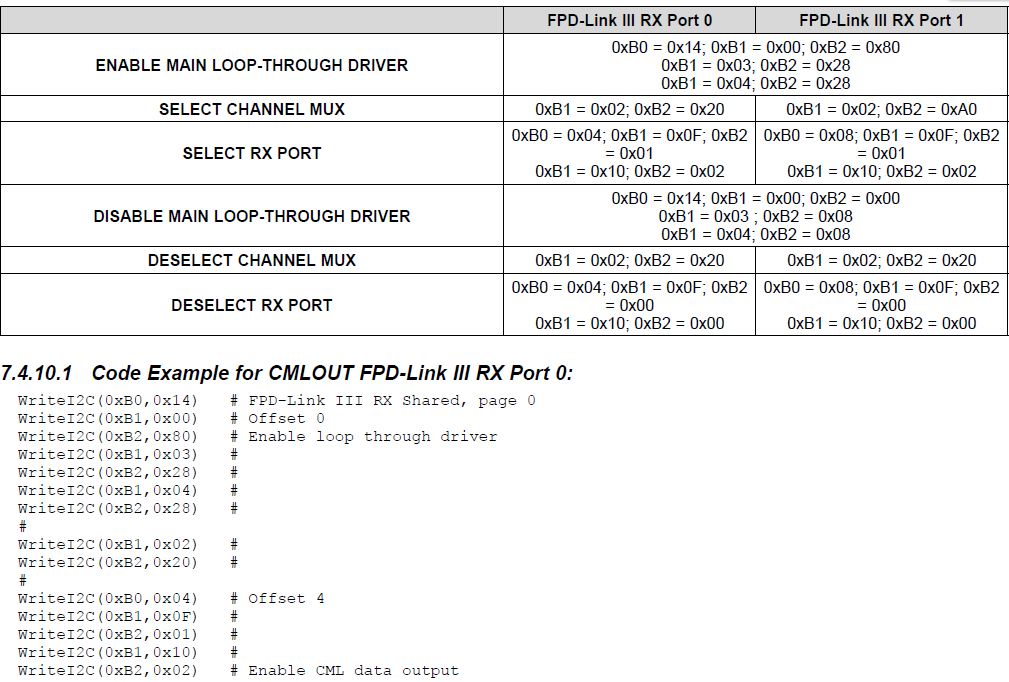

Hi
we are trying to get eye pattern on CMLOUT pin.
we follow 90954 d/s at below to enable CMLOUT output
but we still look like a noise signal on CMLOUT pin, We not sure enable CMLOUT output is success or fail
could help me about :
1)show a exsample picture of  waveform of FPD Link III singal.
2)code sample of enable CMLOUT output , RX Port 0 , Power on Coax
we will cross-comparison.
Thank you
