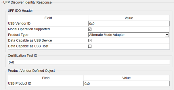

Hi Eric,
I have some questions regarding to the System Settings and the UFP Discover Identity Response.Your device is a PICe extension and includes just the TPS, TBT3 and 4 PICe cards.
What means the Customer Version? Is this something like the model revision? The XID I think is the USB-IF: USB Power Delivery ID, right? Should I need this if I don´t use an USB-device?
 The same questions to the UFP Discover Identity Response like before.Did I need an USB Vendor ID, Certification Test ID and an USB Product ID, if I just use the Thunderbolt?
