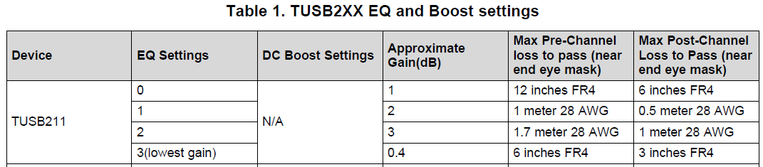

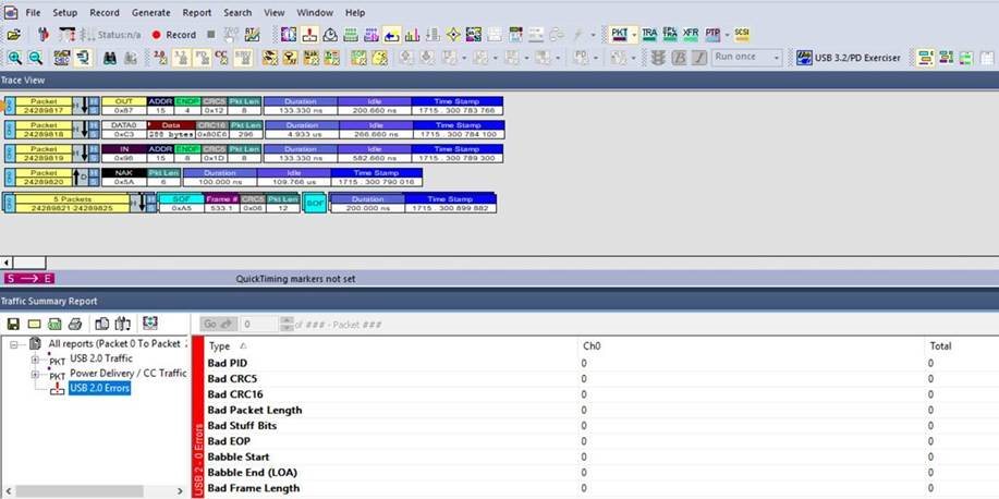

My customer is seeing interesting issues around the TUSB211 in their design. There are two products (a host and a dock) which are connected to one-another through a Type-C cable.
With the re-driver in place, they are seeing CRC issues but when it is removed, there are no more CRC issues.
Dock with re-driver:
Dock without re-driver:
In addition, the problem goes away with EQ set to 3. Strange, right?
