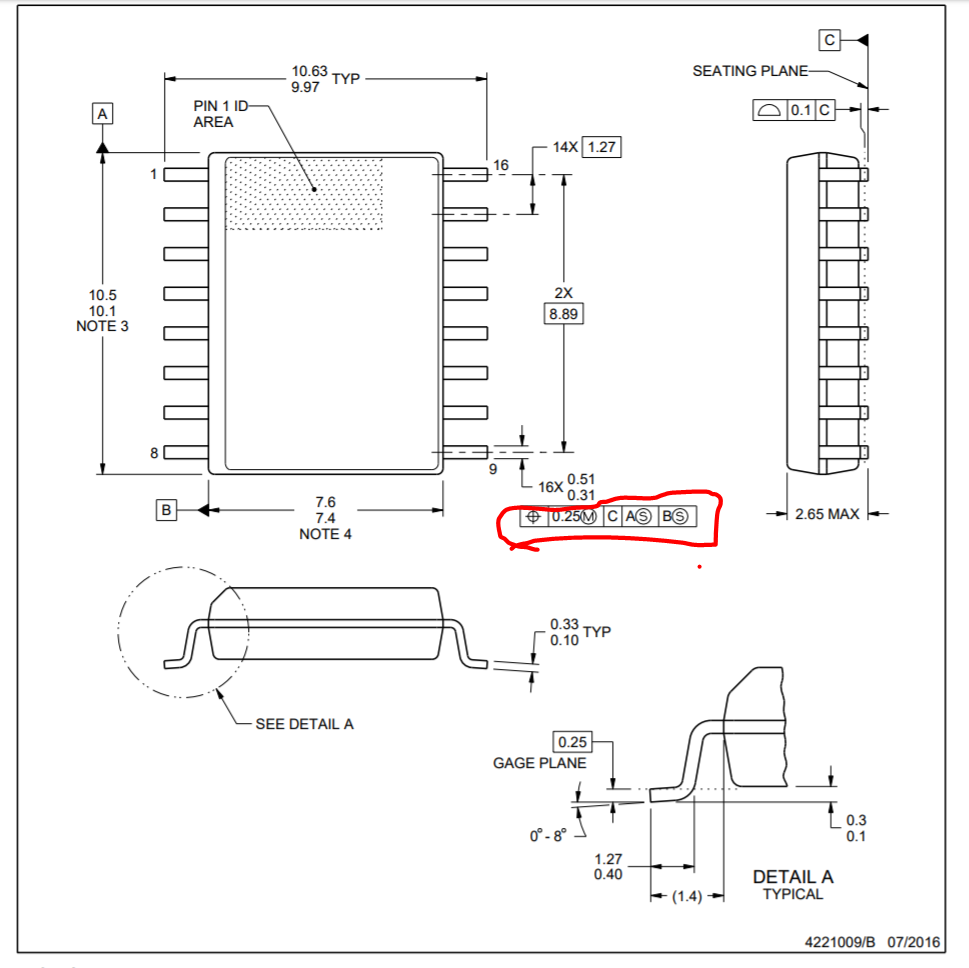

Hi team,
in the datasheet of UCC21520, I am wondering the meaning of the content in red box as below. Thanks a lot!

Hi Yangbo,
These are notes about the mechanical dimensioning of the package.
I've asked my colleague to help you with exactly what they refer to. He will get back to you on Monday, Dallas time.
Hi Yangbo,
The symbol you are referring to is the "Geometric dimensioning and tolerancing" or "GD&T", and is essentially the tolerance of the pin location compared to the virtual ideal planes defined by A B and C allowing manufacturing that is repeatable based on proper (mechanical assembly) function.
The recommended footprint takes this into account and can be used as is. For more details here are two resources:
Definition:
wikipedia.org/.../Geometric_dimensioning_and_tolerancing
Basics with examples, the video also discusses why this notation is used instead of coordinates to locate the feature:
www.gdandtbasics.com/.../
