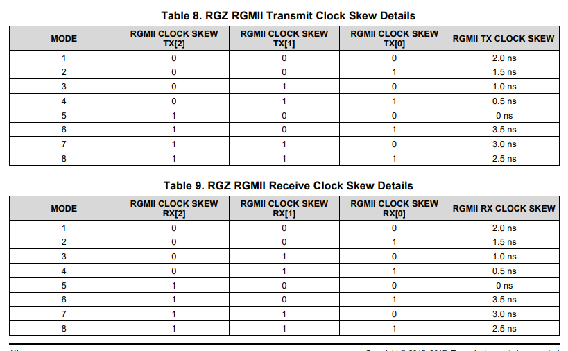

my customer has a question about DP83867. He want to change the TX skew and RX skew, like below show.
So how to change  TX skew and RX skew? does it need any hardware changes? or just change registers? if only change registers, which register should be change? there are many register shown on datasheet.
