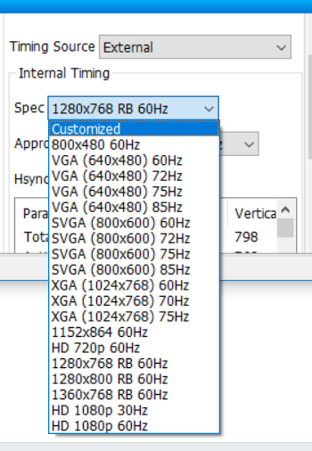

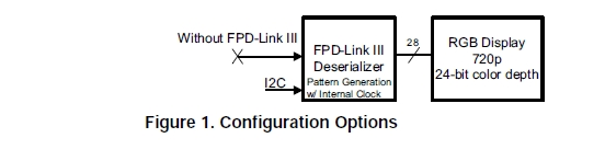

Hello TI Experts,
I am now using DS90U948-Q1
I'd like to use internal PCLK to display pattern,can this way support 1920*1200 Dual LVDS Chanel?

Hi Fawn,
As long as your PCLK is less than 170MHz, the DS90UB948 should be able to support this. You can calculate the exact PCLK you would need with this formula:
PCLK = (Horizontal Lines + Overhead) x (Vertical Lines +Overhead) x fps

This is GUI, if you select internal timing, you can select different clock after scrolling down the menu.
yes, you can use custom resolution.
