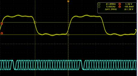

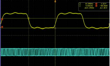

  • Palaniappan-san,
    I attached dump list of DS90UB913A register (not connected to DS90UB914A-CXEVM in this case).
    I confirmed 0x03[1] is set to "0", so It is expected that the 913A device switches from the internal oscillator mode to external PCLK when the PCLK is detected, however actual behavior wasn't true..
    I also confirmed the external PCLK is actually getting into the device. Please see the following waveform.
    1) Without DS90UB914A-CXEVM: PCLK(Yellow) and FPD LNK III output (Blue) were not synchronized
    2) With DS90UB914A-CXEVM: PCLK(Yellow) and FPD LNK III output (Blue) were synchronized
    I would like to know how to synchronize FPD LNK III output with PCLK when using only DS90UB913A-CXEVM itself (not connected to DS90UB914A-CXEVM).
