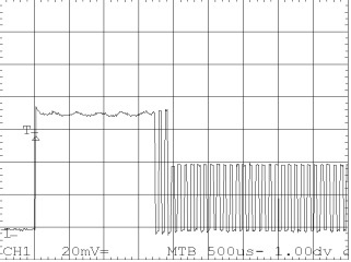

at downstream ports the chirp signal at D- is for K-level only 700mV, but it should be 800mV.
Ís it an intended behaviour? is it so ok?
