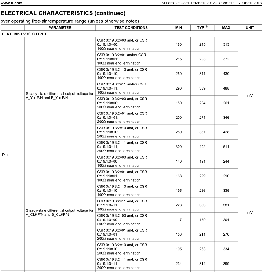

Part Number: SN65DSI84
Could you please share the distribution data for the differential output |Vod| between the lanes in the same device ?

Hi I.K.-san,
Thank you for your prompt reply.
Please provide the expected value as design if possible.
Kato
Hi Kato-san,
I will check to see if there was any comparison data taken between lanes and will get back to you shortly.
