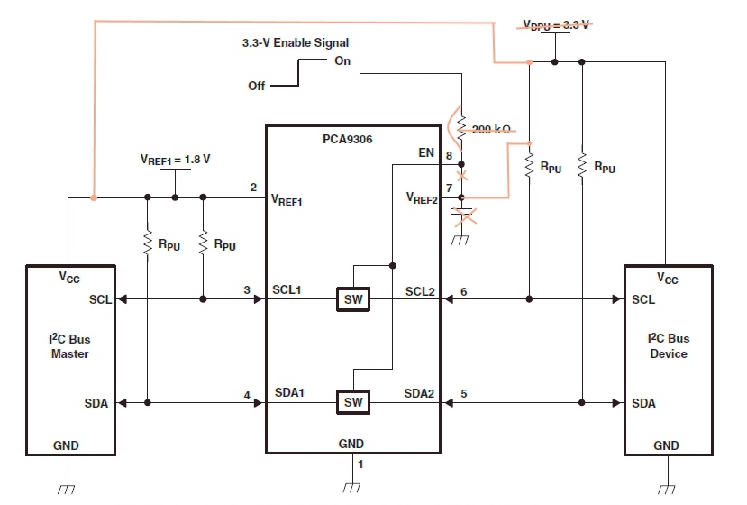

Hello.
Is this correct if in DS for PCA9306 on figure 8 VDPU will be 1.8V?
I need to use PCA9306 as a switch to control the resolution of the I2C interface with a supply voltage of 1.8V.
I needed the resolution of the I2C interface to solve the problem of an incorrect initial state of I2C Bus Master.
I'll provide the 3.3V enable signal.
I do not need to separate the line capacity.
Or so it is more correct?
