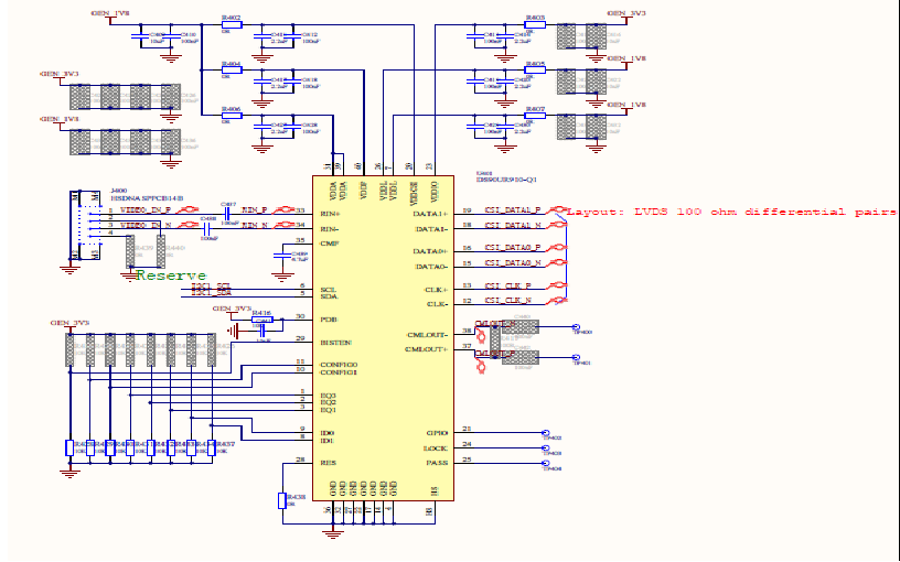

1,Customer had used the DS90UR910-Q1 to design the dash board. After the long time for testing,there has some issue about stability, the screen may to be White screen, black screen, flower screen.
2,  The  video signal  from the car throgh DS90UR905Q,and DS90UR910-Q1 to CPU(I.MAX6),then throgh DS90UR910-Q1 to dash board
3, SCH is as below
4,  would you help give any comments and confirm the mipi-csi2 timing of ds90ur910
