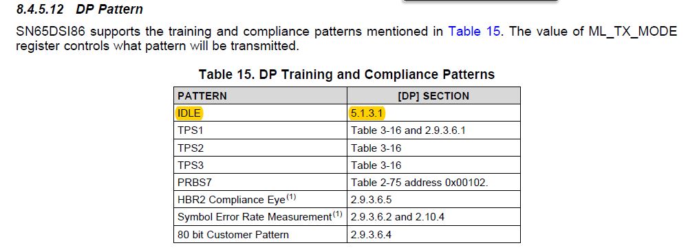

Would you help me to get material [DP section] to see what IDLE pattern is ? It is not easy to find it out in web.

The idle pattern is as specified below:
“idle pattern” (BS symbol followed by the NoVideoStream_Flag and VerticalBlanking_Flag bits in the
VB-ID (bits 3 and 0, respectively) both set to 1 every 213 or 8192 LS_Clk cycles) until it is ready
to insert the new Main Stream Attribute data during the vertical blanking period of the main video
stream. At the very minimum, the Source device shall repeat the idle pattern five times before
inserting the new Main Stream Attribute.
