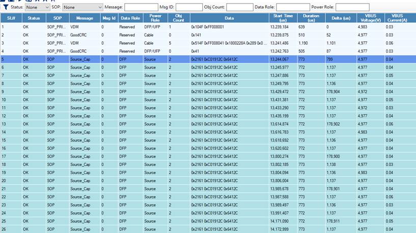

When testing the TPS65987-90 EVM, we found that TPS65987D is not responding to Source (TPS65986 EVM) as the attached log shows.
https://e2e.ti.com/cfs-file/__key/communityserver-discussions-components-files/138/TPS65987_5F00_DRP_5F00_20180716_5F00_Sink.7z
We are using the default UFP template generated by the Applications GUI and all jumpers are at the default position.
Could you please help figure out the cause?
Thanks!

  • Roy,
    Could you please describe the test setup that you are using? How are you trying to test the UFP functionality?
    The Application GUI by default does not support the TPS65987_90EVM when if there is a TPS65990 (U7) on the board.
    Also note that TPS65987/8 does not have USB2.0 and SBU muxes. We are currently in process of doing a new DP EVM that can be supported on TPS65987/8 EVMs.
    Ghouse

  • Hi Roy,
    You are correct that muxes shouldn't make the PD negotiation. I was assuming that you will actually be looking for data transfers (USB3.0 etc.).
    Coming to your failure point of initial PD negotiation, that won't work if TPS65990 is in the path and is not programmed. If you are trying to test TPS65987 only, the easiest path would be to remove TPS65990.
    To remove TPS65990 from the board - follow these instructions -
    1. Remove IC U7 (top layer of the board) and leave as DNI per rev C BOM. Returns ICs (bagged) to TI
    2. Populate Resistors R93 & R96 with 0 ohms per rev C BOM
    3. Remove Resistors R76 and R77, per rev C BOM
    4. Remove Resistors R90, R91, per rev C BOM
    5. And Populate R4 and R5, per rev C BOM
    6. Remove R94 and R97, per rev C BOM
    7. Populate Resistors R2, R3, per rev C BOM

  • Hi Ghouse,
    1. The PD negotiation is now functioning after I removed the TPS65990 and changed the resistors according to your suggestion. Thanks a lot!
    2. May I know the reason why the current version of DP EXPANSION board would not work with the TPS65987 EVM? Is that due to the lack of SBU mux? If that's the case, the board is still supposed to work under one orientation as you mentioned. However, we found that it's not functioning under either orientation. What would be the reason for this?
