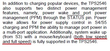

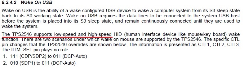

Customer is confused the system wake up with USB device Low speed, Full speed and High speed. What types of USB device that TPS2546 do really support the system wake up? Which statement is correct?
On the page 1 of the TPS2546 datasheet:
On the page 19 of the TPS2546 datasheet:
