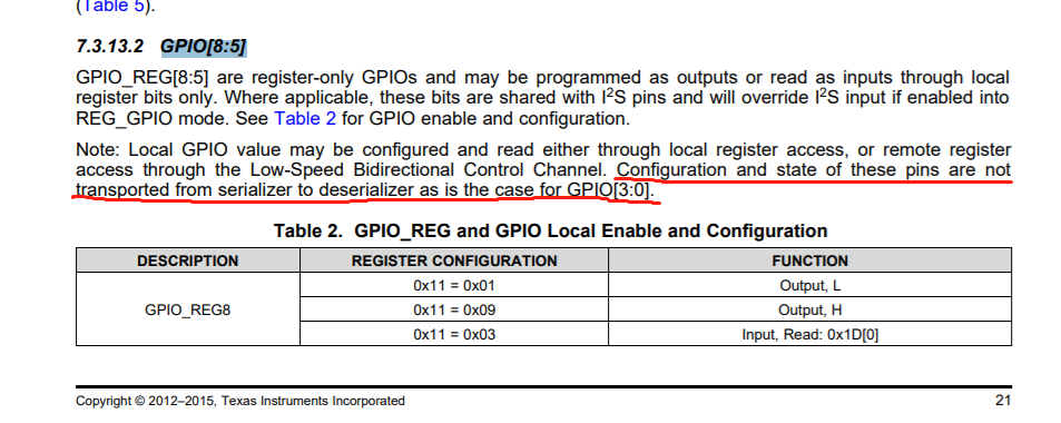

Can GPIO[8:5] remotely control the GPIO of the DS90UB928?
DS90UB927:
DS90UB928:
927 data sheet notes can not.But 928 has GPIO[8:5].
DS90UB927:
DS90UB928:
