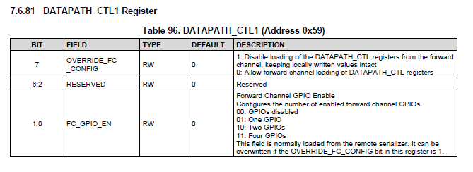

I have a DS90UB953 linked to a DS90UB954.
I would like to use 3 forward Channel GPIO and 1 Back Channel GPIO.
However, I can't find DATAPATH_CTL1: FC_GPIO_EN for 3 forward Channel GPIO settings.
How do I need to set for using 3 forward Channel GPIO and 1 Back Channel GPIO?
Nao
  • Hello Nao,
    There are 3 main controls for GPIO:
    1. GPIO I/O setting & mapping on serializer
    2. GPIO I/O setting & mapping on Deserializer
    3. FPD forward channel GPIO control.
    They are all required. What you configured on the FPD forward channel GPIO does not control the GPIO I/O or mapping setting. You need to set both.
    So you still can set in the 953 reg 0x59[1:0] =11 (Four GPIOs) but configure the fourth one as Back-Channel GPIO, i.e. as input on the 954 and output on the 953.

  • Hello Nao,
    To send a signal from Serializer to Deserializer via GPIO over the forward channel, you will need some or all of the following registers:
    On the 953:
    Reg 0x0E
    Reg 0x0D
    Reg 0x33
    Reg 0x53
    On the 954:
    Reg 0x12
    Reg 0x0F
    Reg 0x59
    For example sending a voltage level over GPIO2,
    On the 953, write reg 0x0E[2]=1 and [6]=0
    Reg 0x0D
    Reg 0x33 = 0x07
    On the 954, write reg 0x12=0x41
                                     Reg 0x0F[2]=0
    Reg 0x59[1:0]

    I was able to use FC_GPIO on our EVM.
    Nao
