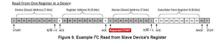

I'm confused how a read makes in accross I2C switch fetches data back.
A plain normal read is described below. With read data coming back after read bit asserted.
The PCA9548A datasheet states
Is that first line a typo, normall read data comes back if read bit asserted?
Then how is a downstream I2C slave device read? The slave too needs address and data phase? How can that be injected?
There is no illustration of how that would be done.
