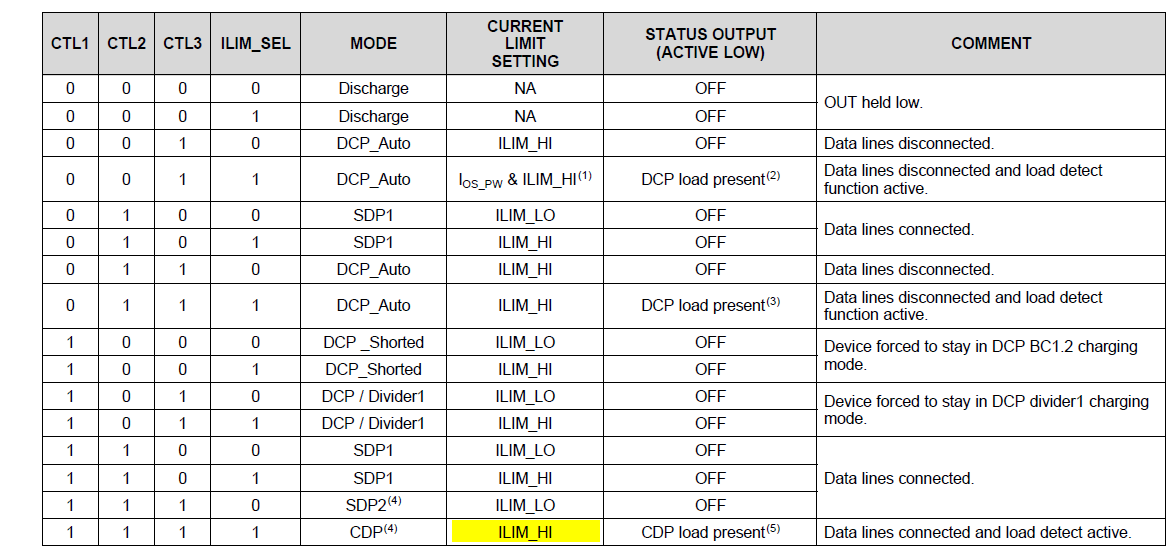

    Are you sure you are configured in CDP mode (no jumpers on CTL pins)? The current limit setting for CDP mode is ILIM_HI not ILIM_LO, so there should be no difference in adding a resistor to that pin when you are in that mode. Also, how are you powering the EVM? By an external power supply or being plugged into a laptop?

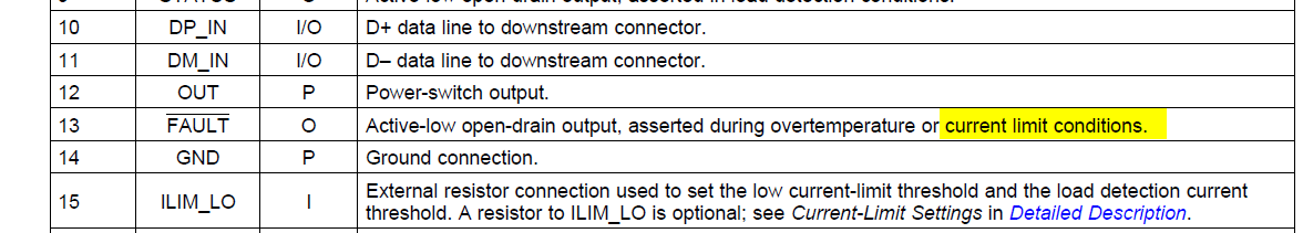

    Can you look to see what the voltage is on VUS, as well as what the current is comping out of VBUS? FAULT is designed to trigger during an over temperature or over current event. I doubt there is a over temperature event happening so it would have to be over current. There may be large current spikes that the TPS2546 is detecting as an over current event, and triggering the OCP feature.

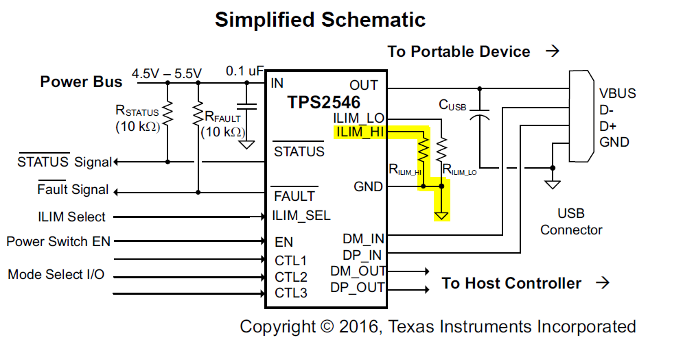

    Those are correct value and should not be causing an error. However, I just re-read one of your previous comments, and ILIM_HI cannot be connected to 3.3V, but instead needs to be connected via resistor to GND. I would try fixing this connection and see if it fixes the FAULT issue.

    In our schematics we have connected ILIM_HI to ground through a resistor which is setting the high current limit. As the fault pin was toggling when the ILIM_LO pin was open, I added a resistor to ILIM_LO pin. ILIM_SEL pin is pulled high to 3.3V.
    Is ILIM_SEL which is connected to 3.3V causing the issue? In our schematics we are using 2 more TPS2546 where they are working in auto DCP mode and the ILIM_HI pin is connected to ground through resistor for 2.1 and 2.4A current limit.

    When we connect the phone to TPS2546 the fault pin is immediately going low, where the fault pin should not go low unless there is over temperature or over current fault.

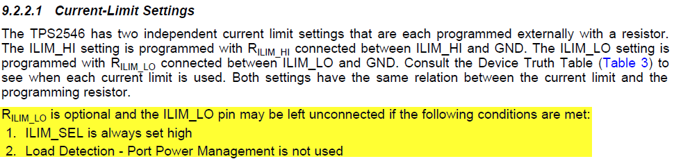

    This does make sense as the current setting during CDP mode is ILIM_HI, so changing the resistor tied to ILIM_LO should not have an effect on the current setting. I would suggest checking to make sure that:
    1. The TPS2546 is in CDP mode. Meaning that CTL1, CTL2, CTL3, and ILIM_SEL are all pulled high
    2. That the resistor you are changing is tied to ILIM_HI
    3. That the pads for pin 15 and 16 are not shorted together
    Also if you do not need to use ILIM_LO, I would suggest removing it. It sounds like your problems started to occur once you included ILIM_LO into your design. If you do not need it in your system, I would remove it.

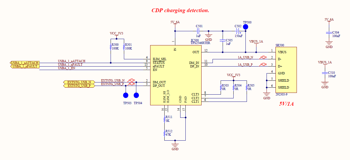

    I have attached the schematics for your reference. In the schematics the ILIM_LO pin is open, for testing I have added a 3K resistor.

    I see your problem now. The current limit you have associated with ILIM_HI is too low. You can calculate the current limit using the following equation. Using the resistor values you have tied to ILIM_HI, your highest current limit is set to 1.005A.
    50,250/50,000 = 1.005
    This is a problem because CDP charging allows up to 1.5A, which is what most portable devices will try to pull if it detects that it is connected to a CDP charger. Since your current limit is only set to 1.005A, you will get a FAULT signal because it will see this as an over current condition. If you decrease the resistor value tied to ILIM_HI to at least 33.5k ohm, the fault should go away.
  • Hi Adam,
    After changing the value of ILIM_HI resistor value we are not getting fault.
