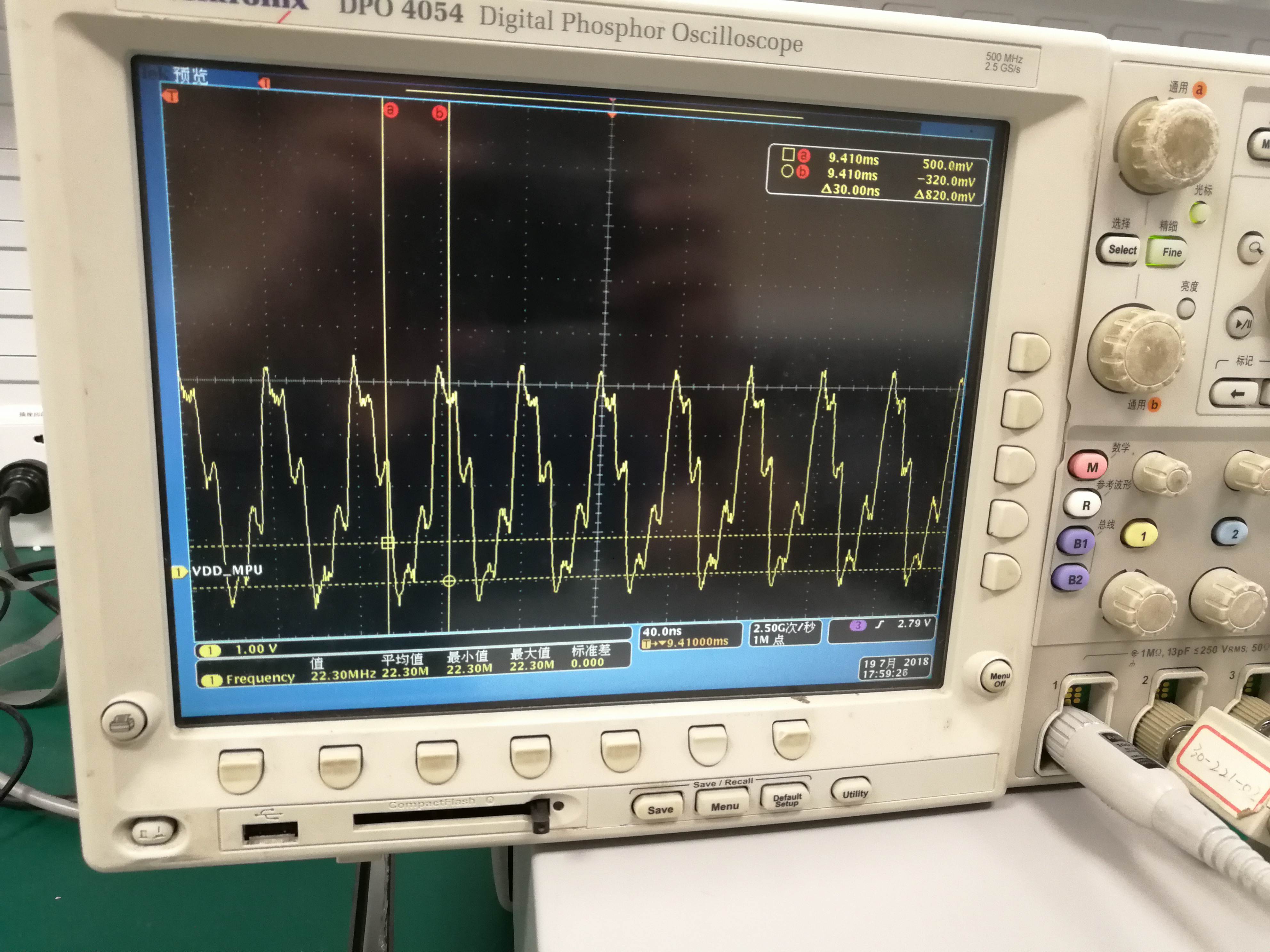

when in advertised modes and link the mac for the first time bootloading SW, it seems that the TX_CLK(25Mhz) has phase shift leading to the strange waveform for TX_CLK, while the RX_CLK has no phase shift.

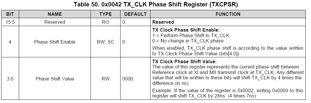

And I found the statement in the datasheet of DP83822 as follows.
So,  can this register of PHY be changed when bootloading?  Is this the reason why the TX_CLK has strange waveform?
