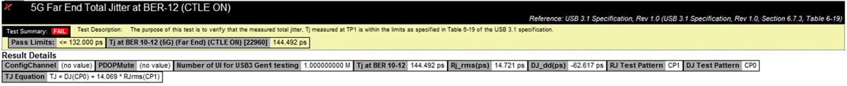

We face an issue that jitter test fail. Please kindly give us some suggestion.
Any TUSB544 register change can improve this?
Hello Daniel,
I would suggest adjusting the DTX1EQ_SEL and DRX1EQ_SEL registers as listed on page 41 section 7.6.1.10 of the datasheet.
