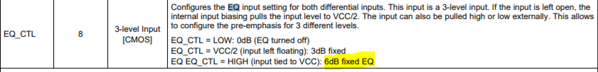

Hi
I got one quick question.
Where between the connector and the receiver should i place SN75DP119 ?
Should i put the chip more closely to the connector or should i put it more closely to the receiver? how to decide?
Thanks!
