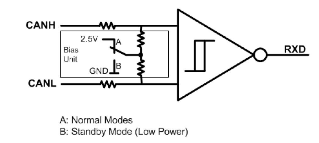

    It can be seen from the figure below that Bias unit switches to GND at standby mode. That is why I thought it will pull down CANH and CANL. Not necessarily to 0, but with some pull down ability. It that correct?

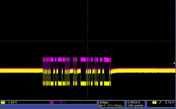

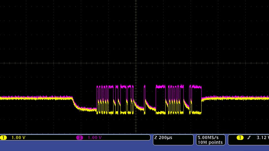

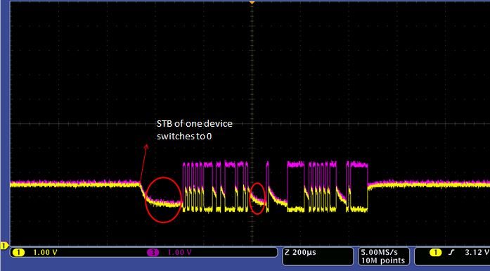

    I also see the same result in my test. If all transceivers are at normal modes, below is the waveform of the bus. But if one of the devices is at standby mode, the bus bias is reduced to lower than 2V, as shown below. So what do you mean by the CAN bus remains recessive at standby mode? And I think the waveform is not acceptable, right?

  • Shirley,
    You are correct in that the CAN bus will be weakly biased to GND, and there should be a decaying value of the recessive level on the bus, but I wouldn't expect it to drop as low as it does. What is the data rate you are using and is there any chance you can share a schematic of the board this device is on?
