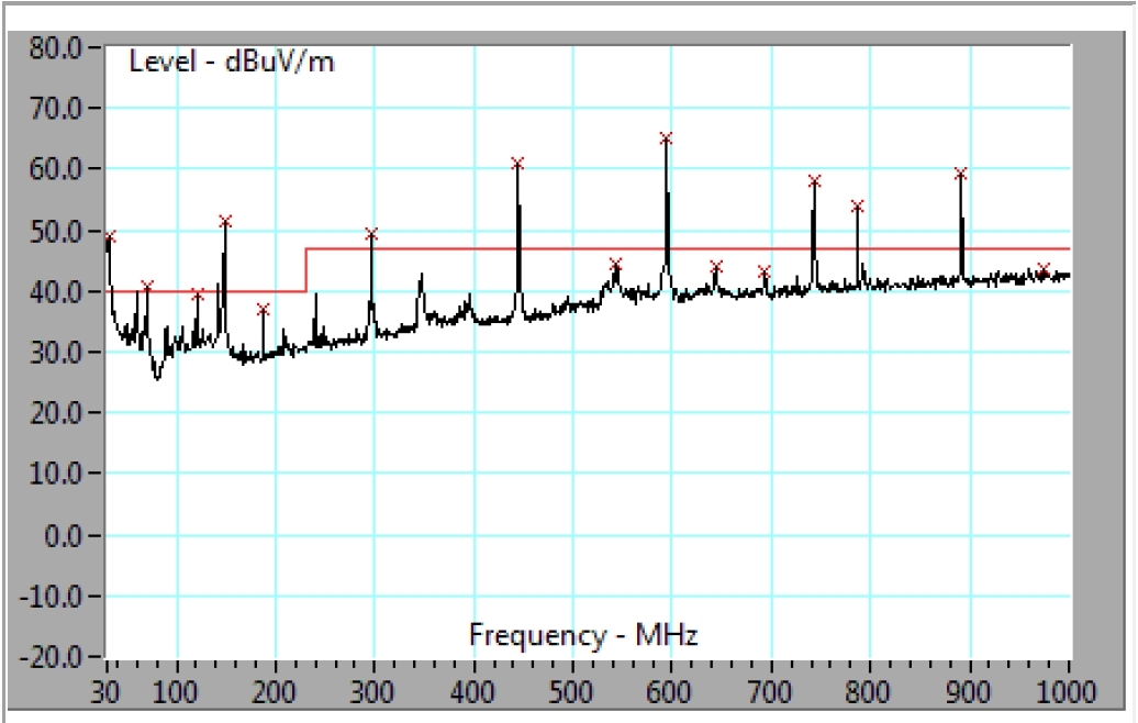

We are failing FCC Class B EMC testing by a huge margin, and are looking for any additional ideas regarding the possible cause (see example frequency scan below; one channel active).

  • HI Gregory,
    What speed data are you running during the test?    These spikes are higher than we typically see for HDMI 2.0 retimers.  As a test, can you try dropping the resolution (4K2K30 Hz or lower) and putting the DP159 into redriver mode, that would help us determine what is sourcing the spikes.  We do recommend 10 pF and 4.7 pF caps on the voltage rails to improve EMC, but that alone is likely not enough to resolve this.
    JMMN
  • We were only running 1920x1080/60Hz and 1280x1024/60Hz for our EMC testing. The plot included here is for the 1280x1024 resolution running only. The 1920x1080 plot looks similar, just different fundamental frequency. We did try redriver mode across full range (using these resolutions), and we saw no effect.
  • Gregory,
    That is very strange, I would expect to see noticeable impact from dropping to redriver mode? What does the baseline for this project look like?
    I also would not expect to see the large spikes at 600 MHz/ 450 MHz, can you provide your I2C settings from the test?
    JMMN
  • JMMN,
    Sorry for the delayed response - I thought this thread went dark.  The baseline, with HDMI disabled, shows no violators.  See below.

  • Hi Gregory,
    One of my team members noticed that the baseline for your testing is very high.  This is a baseline we took during EMI testing and I checked on several 3rd test reports and they are showing similar baseline results.
  • Thanks for this key observation. Will investigate this further.
