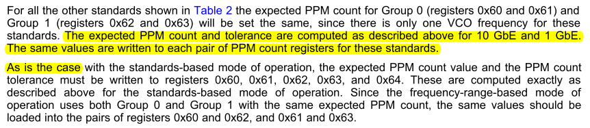

From the description in the datasheet below,
I am understanding that the data rate shown in the standards based mode table does not require REG 0x60-0x64 PPM settings, only REG 0x2F setting is required for VCO setting. a
m I correct  ?
My understanding is that above "For other data rates" means the data rate which is not shown in the above table.
Below paragraph notes that REG 0x60-0x64 is required to be written when VCO0 and VCO1 needs different settings like 10GbE and 1GbE.
As long as only used in the bit rate which described in the standards based mode table, I believe user would not require PPM count and PPM count tolerance registers.
Could you please clarify ?

    I believe your understanding is correct. As long as we are going to use standard data rates - as noted in table 2 - we need to use reg 0x2F only.
    Also, data sheet is correct in saying VCO0 and VCO1 need different settings like 10GbE and 1GbE. This is because 10GbE or 10.3125GbE and 1.25GbE are not integer multiple of one another. Therefor we need to use one VCO with divide by one to lock to 10.3125GbE and another VCO - 10GHz - so we can lock to divide by 8(1.25GbE).
