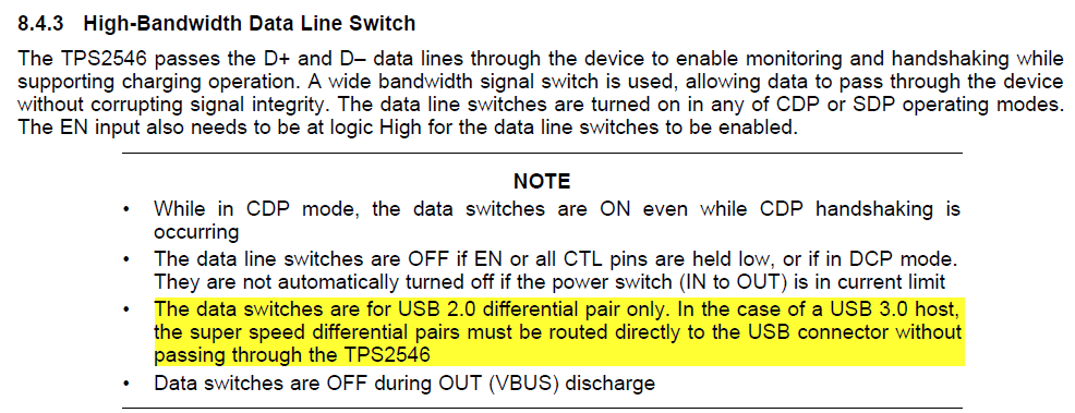

Due to customer 'd like to provide 1.5A current when work on USB3.0. Does any one could help to know the TPS2546 could support USB3.0& BC1.2 exist side by side? if no, have another solution can support ?

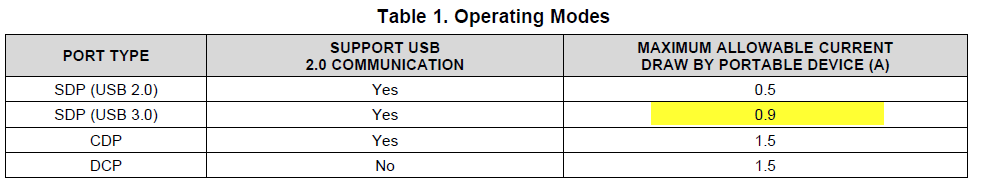

let me double confirm it, so when detect USB3.0 plug in, the output current still can support 1.5A? from the datasheet, SDP(USB3.0) , only provide output current 0.9A.

Yes, when a USB3.0 device is plugged, the TPS2546 can support 1.5A. However, the TPS2546 can only supply a max of 900mA in SDP mode to a USB3.0 device, as this is what the BC1.2 standard limits it to. CDP and DCP charging modes can charge at 1.5A.
Let me know if this answers your question or not!
