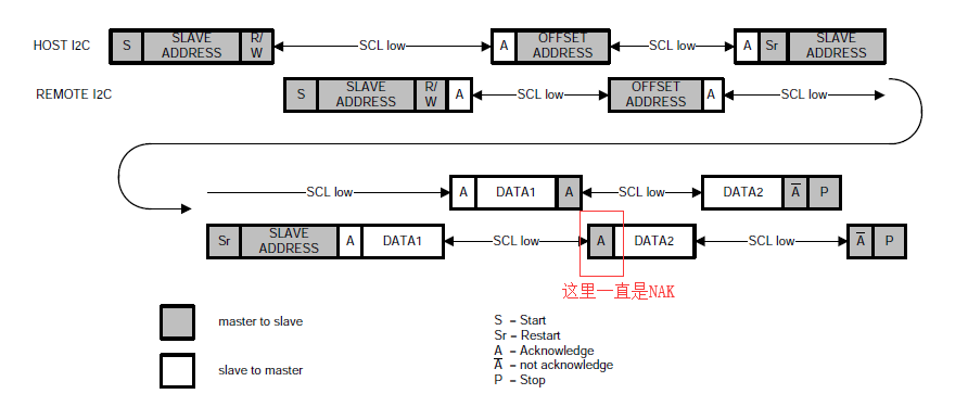

I am now using DS90UB948 and 948, and meet with a problem needs your help:

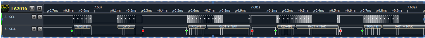

During the continuous read operation, firstly,948 can successfully write the register,after that ,when I do the read operation,their will be NACK
Like the picture described as below:
It is normal to read one byte at a time, but when read more than one byte continually,their will  be a NACK signal(The device supports read continually )
Can I know why?Looking forward to your help~
