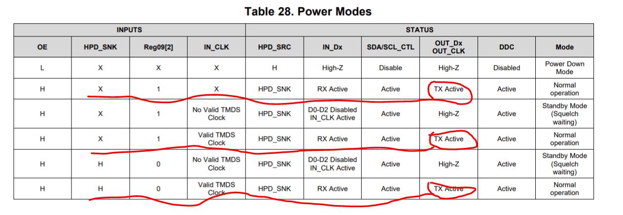

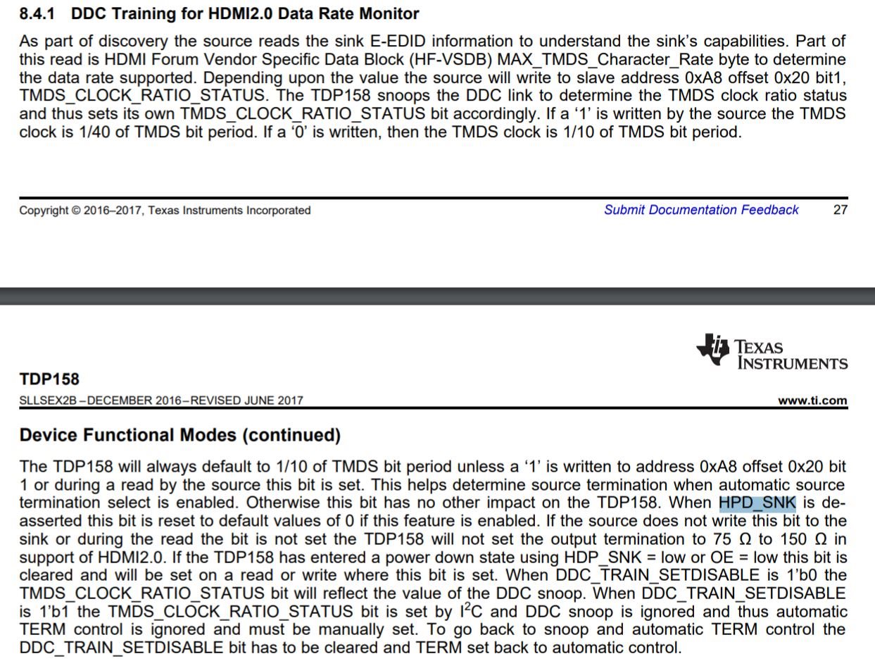

our customer is using TDP158 for HDMI redriver. But we found that:
when we don't connect the HPD_SNK, the HDMI will don't have any output, but when take the HPD_SNK to connect to HDMI socket. It will get the output. could you explain how the HPD_SNK work here? I think the capture should explain it. how to understand the work theory.
